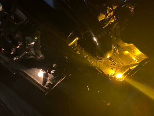

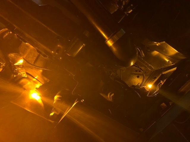

Got it working and figured out.
I tried some new polarity sensitive T10 LEDs that I got from Amazon (cheapo not high end but not the worst I guess) $11 for 12 of them. I put those in with the morimoto XB LED 1157 and it worked! However the XB and side markers were like 1/2 power/brightness. I swapped out the XBs for new 2357 incandescent bulbs I got from Amazon and boom full power to both. Honestly these 2357 are the same brightness as the high powered LED XBs and some of the other Amazon HO LED bulbs. Besides the slightly slower on/off time Im good with this. Best part is the 2357 is $9 for 10 bulbs and super easy to change out lol.
Took some pics for you guys and a sneak peak to my new fog lights which have built in DRLs and are stupid bright but arent true fogs (Silvana LED light bar 10* spot). Im not impressed with the low beam of the JW speaker 8900 series 5x7 and when I had DOT SAE fog pods they helped short distance but I need more distance without running the high beams all the time. Im havent driven to take any good output shots but they throw a lot of light and quality construction with real Osram chips. I will be putting a thread up soon.
XB turn signal see how dim the marker light is on the right
2357 bulb same brightness as 1156 on low setting, side marker is full brightness now.
Driver side done, 2357 turn signal and LED side marker. No noticeable dimness from the XB on pass side and 2357 on driver.
