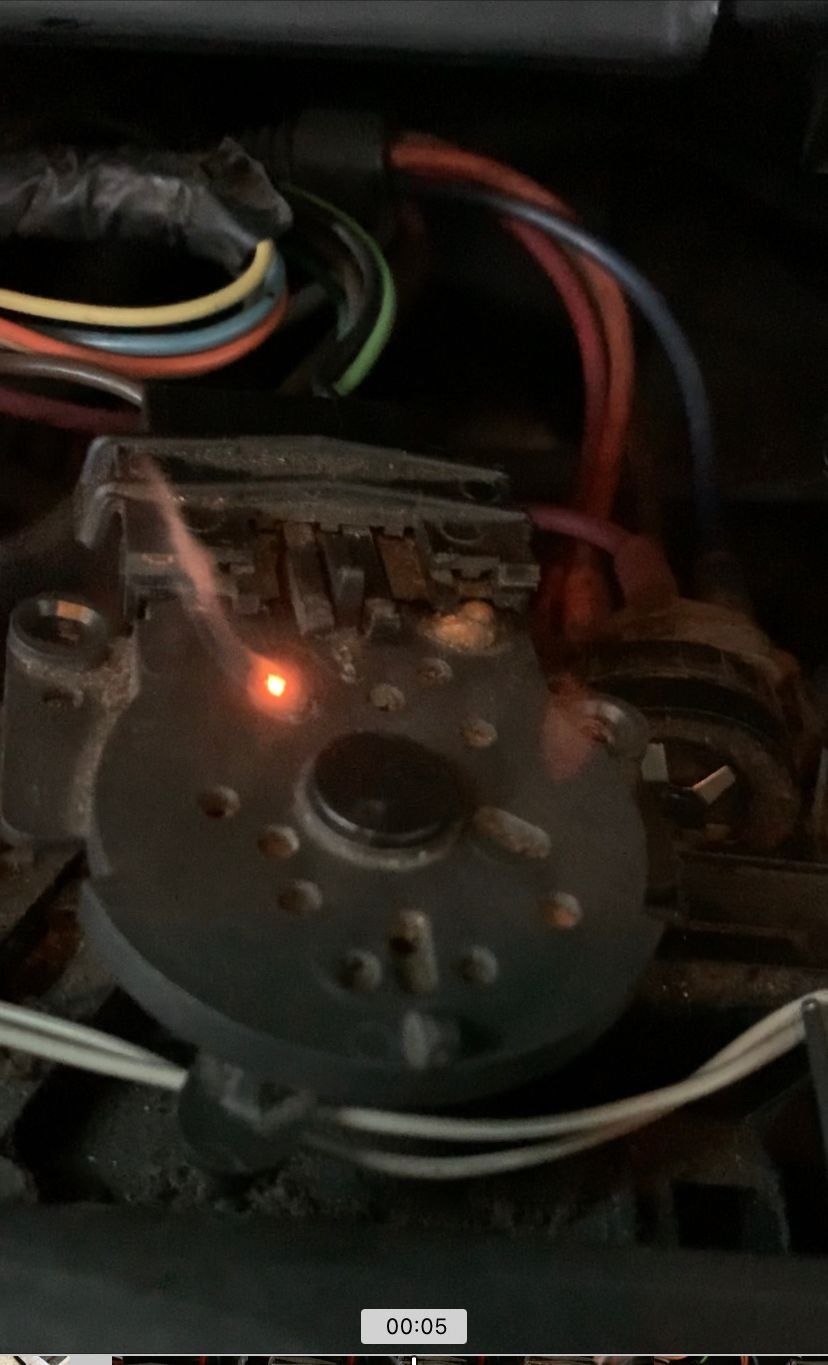

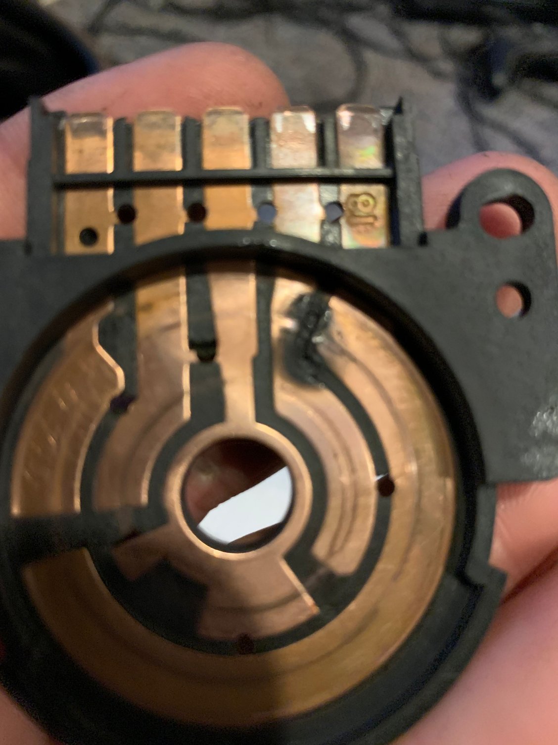

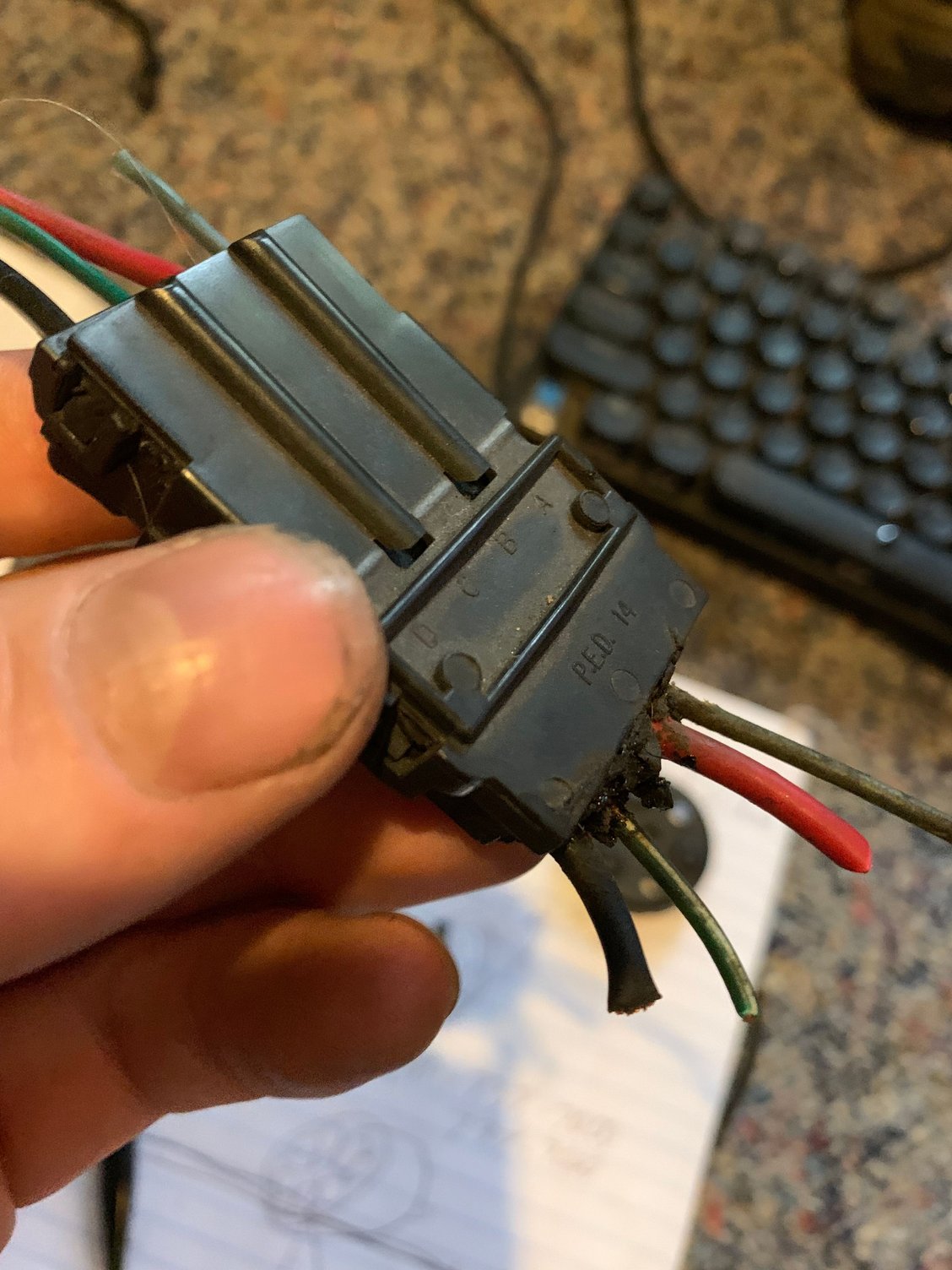

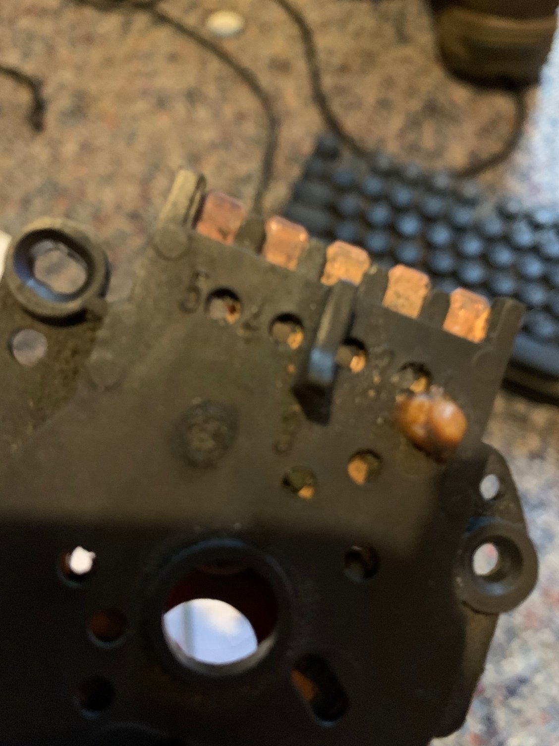

Hey folks, I landed my dream car 8 months ago. 91 firebird convertible and have done a fair amount of work to it. The hvac heater switch literally glows orange and melted between pins 4 and 5 , but everything works. Also noticed a melted connector under the hood that controls the cooling fan and blower. I did replace it carefully.. I can’t for the life of me find that 5 pin rotary switch or even a part number anywhere. Anyone have an issue like this? And for the love of god, anyone know where to get one??

About the only way to get that switch is likely to be, a car that's getting parted out. Might want to watch the classifieds on this site. People do that all the time. Might have to wait awhile for a car that has what you need to appear (probably not, but maybe), since after all, it's kinda hard to place an order for someone to go out and wreck their car and sell it to someone who will make it available to you.
Looks to me like you have even more wastage than usual in that part of your electrical system. (which is rather remarkable... EVERY ONE of these cars burns up all those connectors sooner or later) All that stuff is REAL BAD about burning up, but yours is beyond the pale. I'd be REAL SUSPICIOUS of your blower motor; maybe, just replace it. It's not too $$$ anyway. I'd be concerned that you could replace all that smoked stuff, and as soon as you turn it on, your narfed blower motor would just burn up all your new crap too, same as it did the old. Also, if you follow the brown wire away from your control head up into the dash, within a foot of a foot and a half, you'll come across another one of those INCREDIBLY STOOOOPID connectors, same design as the one under the hood that you already found burned up. Odds are, the one in the dash, which is what supplies power to the entire thing except for the blower high speed, is just as bad as the one in your photo. Replace it too.
