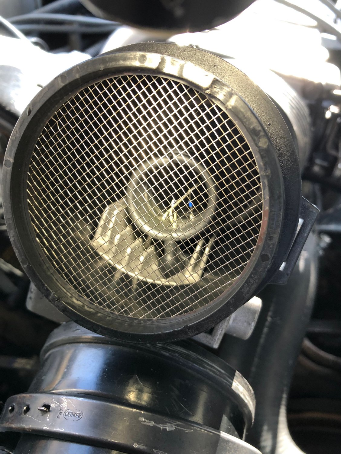

Apr 14, 2023 | 08:06 PM
Re: 86 iroc z code 36
This is the one I have. I’m not sure what brand it is but I think I got it from oreillys auto parts.
Reply 0

Apr 14, 2023 | 09:10 PM
I honestly don’t even know what brand this is. The inside doesn’t look like any of the ones rock auto sales, the Delphi, BSE, Cardone. I do remember this one looking different from the inside from the original one. The car came with a Bosch brand

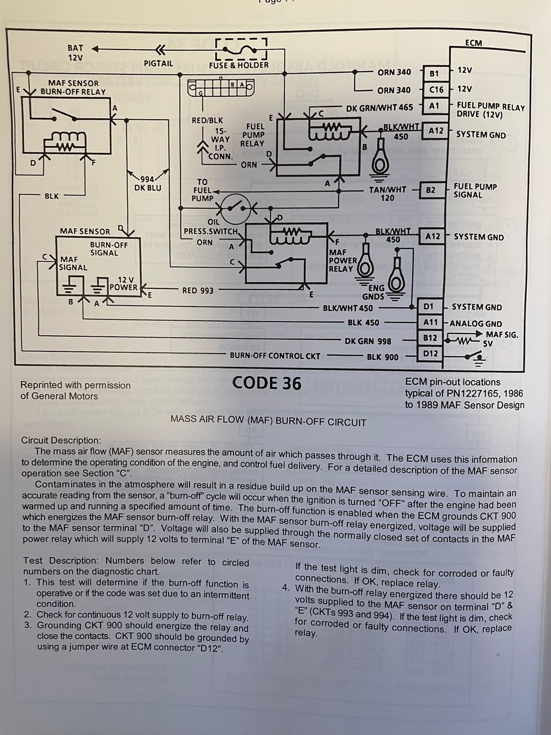

Apr 16, 2023 | 11:00 PM
Quote:
I have this same book.
how exactly would I ground ckt 900 or any other the wires it mentions? Get a wire from the wire to a bolt or negative post of the battery?
Reply 0
Apr 17, 2023 | 08:38 AM
Circuit 900 ground with jumper wire to dash frame or negative side of the battery.
Reply 0
Apr 17, 2023 | 09:53 AM
Quote: Circuit 900 ground with jumper wire to dash frame or negative side of the battery.
oh ok thank you.
Reply 0
Apr 17, 2023 | 09:58 AM
dash frame you mean the metal frame of the car right? I guess I’ll just have to cut the plastic on the wire a little just to wrap around the wire and ground it

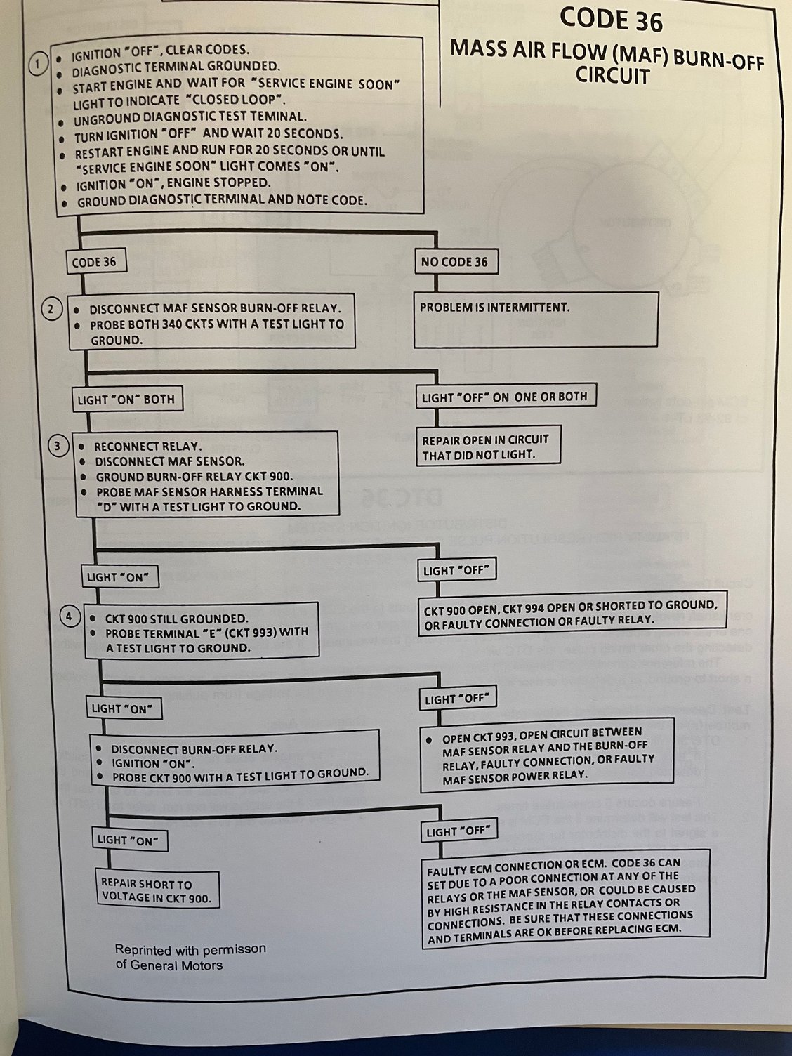

Apr 17, 2023 | 07:43 PM
Ok so I followed the diagnostic and everything passed and got to the bottom of light “off”.
meaning faulty ecm connection or poor connection at the relays. The relays are new with pigtails connectors and I have a new ecm. So I’m guessing I just have the wrong mass air flow and I might just have to buy another new mass air flow. Going to buy the rock auto Delphi brand.
Reply 0
Apr 20, 2023 | 08:46 PM
Purchased the new Delphi mass air flow sensor and it ran way better. I now had power up the hills but after an hour of driving and driving it a little fast, I got code 33 and 43. I just can’t keep these codes off. I already have a new knock sensor. Really don’t know what to do.
