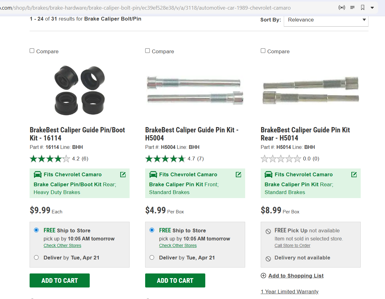

The front pins are 5/16 diameter, 7/16-20 threads, 4-3/8 long, shoulder length 2-7/8, length of threads 3/4 (19mm)
The rear pins are 5/16 diameter, 7/16-20 threads, 4-5/8 long, shoulder length 2-7/8, length of threads 1/4 (6mm)
2 different part numbers in my 82-92 F Body Parts manual (dealer parts book)
The picture is the type of caliper I have - replacing what came on the rear end when I purchased it several years ago. Thought about different rear calipers but I bought a new set and was given another new set by a friend. Don't want to have to buy new ones again and not sure about fitment on the rear end.

Based on that, reduce thread length, shorten pin length, and they might work? Who has a side by side image?

Re: Rear Caliper Slide Pins
From oreillys site. Those cast iron calipers were used on third gens from 82-88, 89-up are the PBR aluminum calipers, but i cant imagine GM only used those particular calipers on 3rd gens though.
