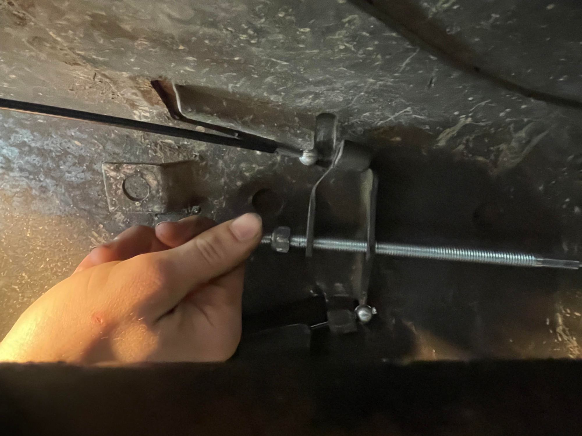

I recently started a parking brake cable replacement and rear brake replacement for my 1983 firbird which has drum brakes. The problem that i have run into is that it seems the rear right parking brake cable I purchased is too short. There are grooves that the previous cable sat in to hold in place, but this cable does not even reach to there. The brake cable for the left rear seems to fit fine and looks to sit in the same spot that the original cable sat in. The cable I bought was a DORMAN C93215 from Rock auto as that was the only cable online that explicitly stated to be for drum brakes (Brake Cable Link). I was wondering if anyone else has ran into this issue before or if there is a better part to buy with a correct length. I am pretty new to working on cars and have never dealt with drum brakes before. I will attatch the image showing how short the cable is to this post. There is a spring on the end of the cable that attatches to the brake and I can pull a little bit more but it becomes very tight which I assume is not wanted.

Looks perfectly fine to me. Not sure what you're thinking it should do instead, butt, looks well within the normal range of things, in an overall general sort of way. So here's the procedure.

This picture I took is just the cable in the mounting points, so not connected to brake shoes. There is no brake hardware in right now as I am replacing the brakes as well as the cables. I put the stock cable and new cable side by side and the stock cable was about 3 inches longer than the new cable I got. So I do not think that your reply will help me much.

pull really hard from both directions.
