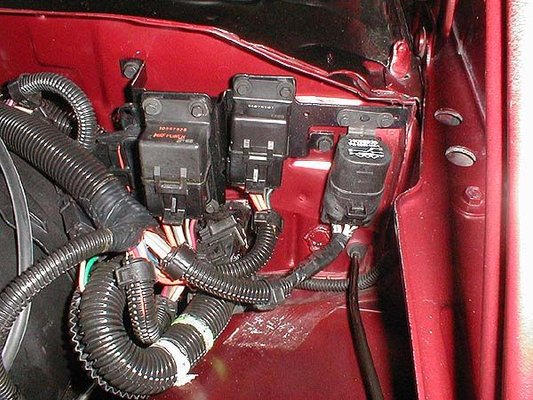

First:
Upgrade from your Original (Early Design) Electric Fuel Pump Relay and Electrical Connector, to the Newer (Late Design) Parts shown below.
The Image below shows 3 Relays... 2 are the Early Design, but the Relay on the Right-Side has been upgraded to the Newer Design:
-Electric Fuel Pump Relay (Standard Motor Products = Part Number "RY109"):
-Electric Fuel Pump Electrical Connector Pigtail (ACDelco = Part Number "PT1115"):
If you need help Wiring/ Connecting the New Electrical Connector Pigtail (such as, which Wire goes to which Wire)...
Please just Post here, that you need help.
Second:
Based on the Original Wiring for a 1989 F-Body with the 2.8L MPFI V6 Engine, One Wire from the Electric Fuel Pump Relay needs to be wired differently.
The 18AWG Dark-Green Wire with White Tracer is the Positive Trigger, and goes to the PCM Connector.
This Wire will need to be cut, and then connected to any Ignition switched Power-Source (12V Positive).

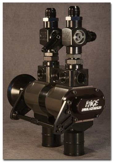

Fifth:
While there are Mechanical Fuel Pumps that will support over 700+ HP (in the Stock Location)...
(And when run off of the Camshaft, Crankshaft, or Accessory-Drive, they support 5,000 HP - 8,000 HP)
I recommend staying with the Electric Fuel pump.
