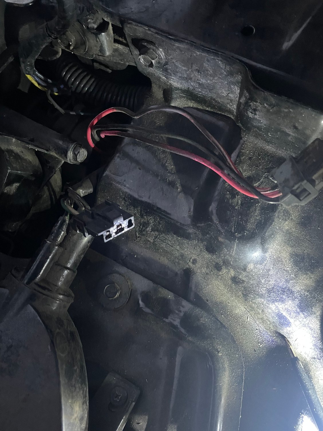

I need some help with my 1984 Trans Am head light motors. The headlight switch will turn the lights on but not the motors. I’ve been using this diagram. If I hit the red/white wire on the isolation relay, both headlights come up. If I hit what I believe is the white wire on the isolation relay, the driver side headlight goes down but not the passenger side headlight. If I hit the pink wire on the passenger side relay, the driver side headlight goes up. putting 12v on the red, green, or gray wires on the passenger side relay does not do anything. I didn’t try to put 12v to the black wire because that’s ground. Does anyone know why I can get both to go up but only one to come down?
