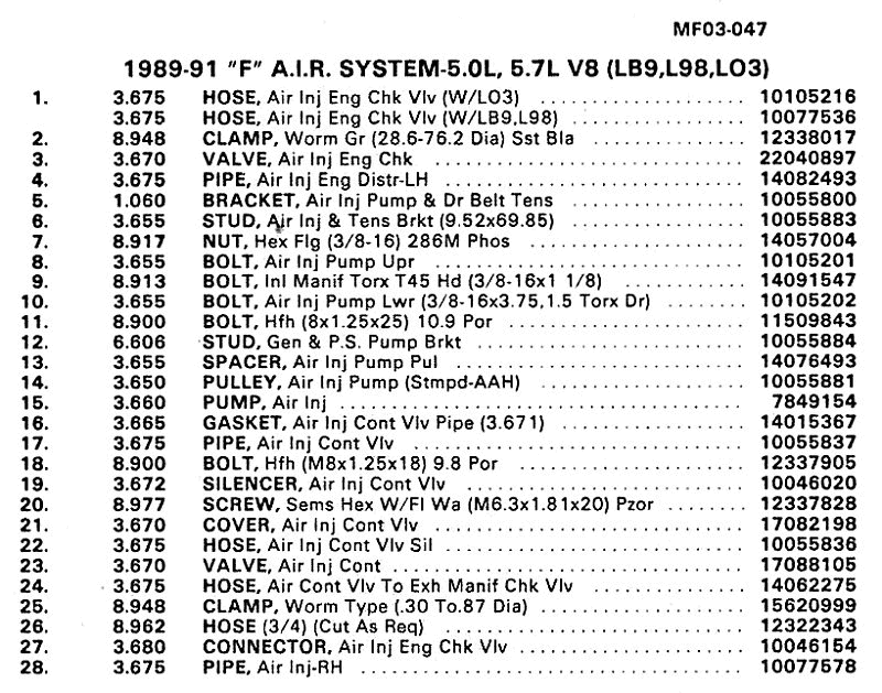

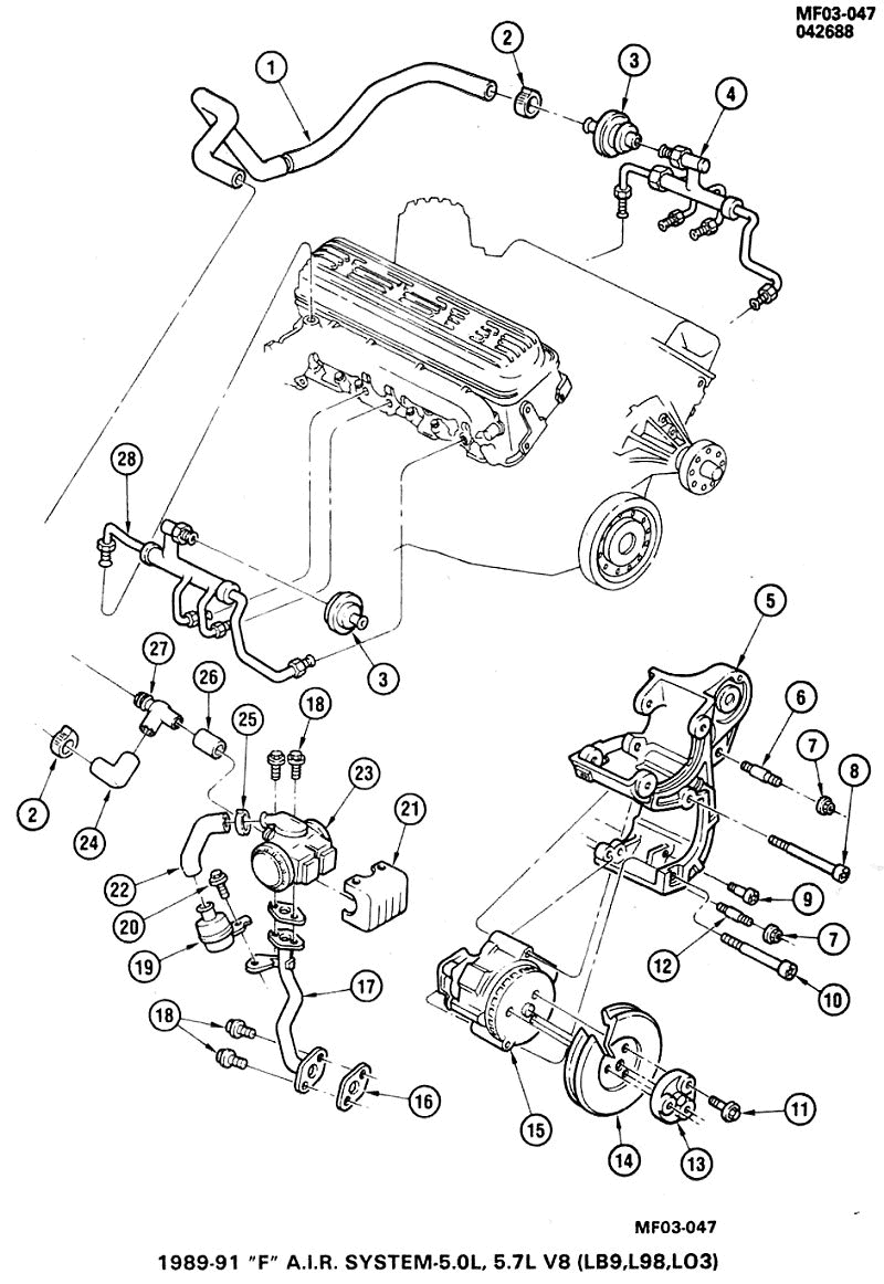

I am ALMOST ready to install my crate engine SP350/357 + FIRST INTAKE, exhaust, headers...but I didnt organize or document as good as I thought in 1991 Firebird Formula.
I have been looking for studs (male torks) mounting locations, & think I have 4(2 a.c. / 2 p. steering) correct. Going through forums, youtube, PHOTOS I took, and "G.M. Serpentine Conversion Kit" instructions I am still unable to I.D. which bolts I have left (I believe that GM. kit hardware isnt EXACTLY" the same) If anyone could point me in direction of images of bolts & studs, to help narrow it down it would help alot. Thank you, I realize now that I should of been more thorough than I thought I was.

Does this help?

thank ya . tryin to get my head around it. what does the second column of numbers refer to? (2.275 in first image.
1.) __ 2.275 GENERATOR... #10463092
i really appreciate it.

Group and part number
