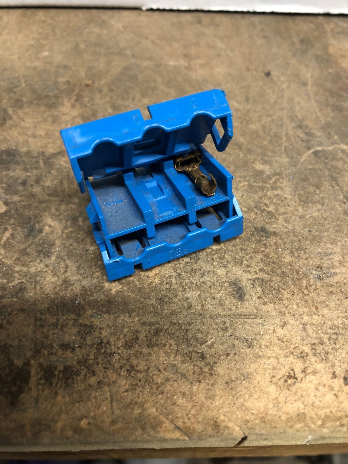

What is this terminal called & where to buy?
Anyone know what this electrical terminal is called and where I can purchase some? These are inside the dash side hatch release connector that my switch plugs into on my ‘84 TA.

Female spade, can probably get at napa, Amazon or eBay

It is difficult to tell without a size comparison.
It looks like it is one of two possible Terminals.
Both are Delphi/ Packard Electrical Division.
It's either a 56 Series Female Terminal (Try Delphi Part Number: 12124520/ 12124520-L)...
Or more likely it's an unsealed PUSH TO SEAT (NOT Pull to Seat) Metri-Pack 630 Series Female Terminal (Try Delphi Part Number: 12015870/ 12015870-L).
Try: Custom Connector Kits.
Here is a Hyperlink for the #12124520:
Hyperlink
Here is a Hyperlink for the #12015870:
Hyperlink

thanks for the links Vorteciroc
that's exactly what I was looking for
