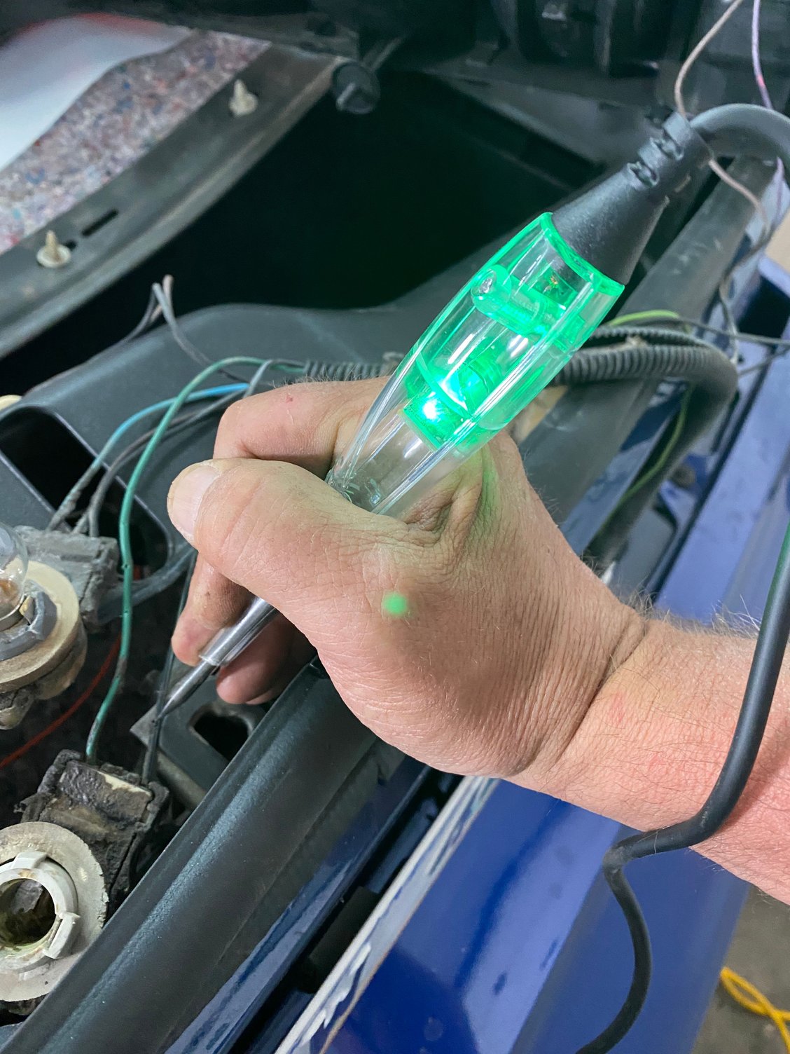

Hey there everyone, I just got my Camaro going after an 8 year restoration. Wow this thing rips.Anyway my right rear signal will not blink or illuminate at all.The front right signal works as i
t should.Blinks ect. Everything on the left side works correctly Bulbs are new.My questions are any ideas what to test? I have verified that there is no power at the socket contact on the inside metal contact band as well as at the green wire leading into the socket. I also ran a wire from the positive on my battery and verified that there is a good ground when I poked the test light into the black wire leading into the socket. I was also wondering why there is a two wire socket with an 1157 bulb in there as there is only one contact in that socket? Any help on this is appreciated.
