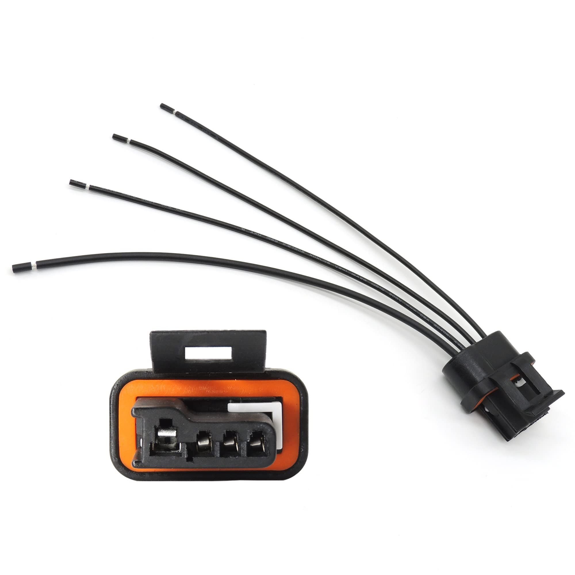

Good Afternoon Everybody and thank you in advance.
I recently bought a new alternator because the old one just isnt keeping up. I have to jump start my car every time it sits for more than a day. The problem is the new alternator has a different connector than my old one does. And so far I haven't found any good information on the pins for either alternator or how to convert the existing harness / connector to fit the new alternator. The car is a 1984 Chevy Camaro Z28 and the alternator is a Speedway Motors 91023130, GM CS-130 style 220 Amp Alternator. I have some pics listed below for illustration. The first picture is of the new unit and the other two are the existing unit and wires in my car. If anybody knows anything about these alternators and the pins, I'd appreciate whatever help or knowledge you can give. Thanks Everybody!

The New Alternator uses the "Later" Design 3rd-Gen F-Body Electrical Connector.
Those cars had CS-130 Alternators Stock.
