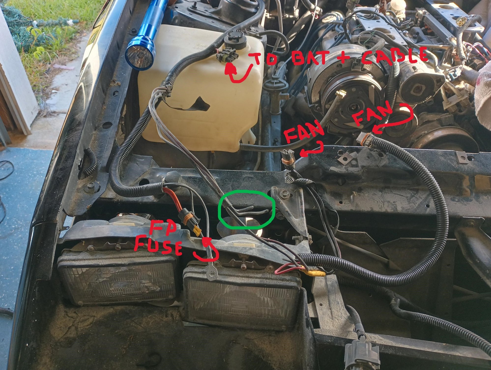

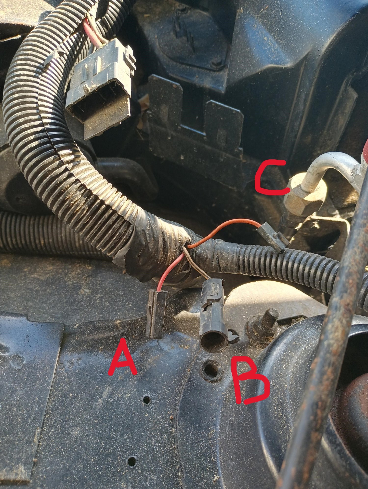

Can use some help in identifying these connectors up by the blower motor housing. It's a 91 harness.
Then in the following picture There are two wires in the green circle that I cannot identify. One wire is Black and the other wire is Black with a Purple stripe. About the same size as the fan connector wiring.

A = Fuel Pump Test Connector
B = ?
C = Under Hood Light

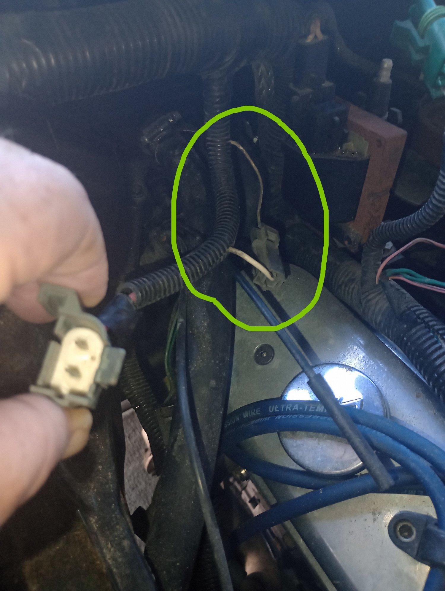

My bad .. TAN/BLK definitely ESC connector...found the other side clipped off and tucked inside harness. As for the second pic.. yeah fan wiring, again some thing got hacked up. Only reason I refused to accept ESC was cause of this stupid one that I forgot about it and trusted source of harness.,
