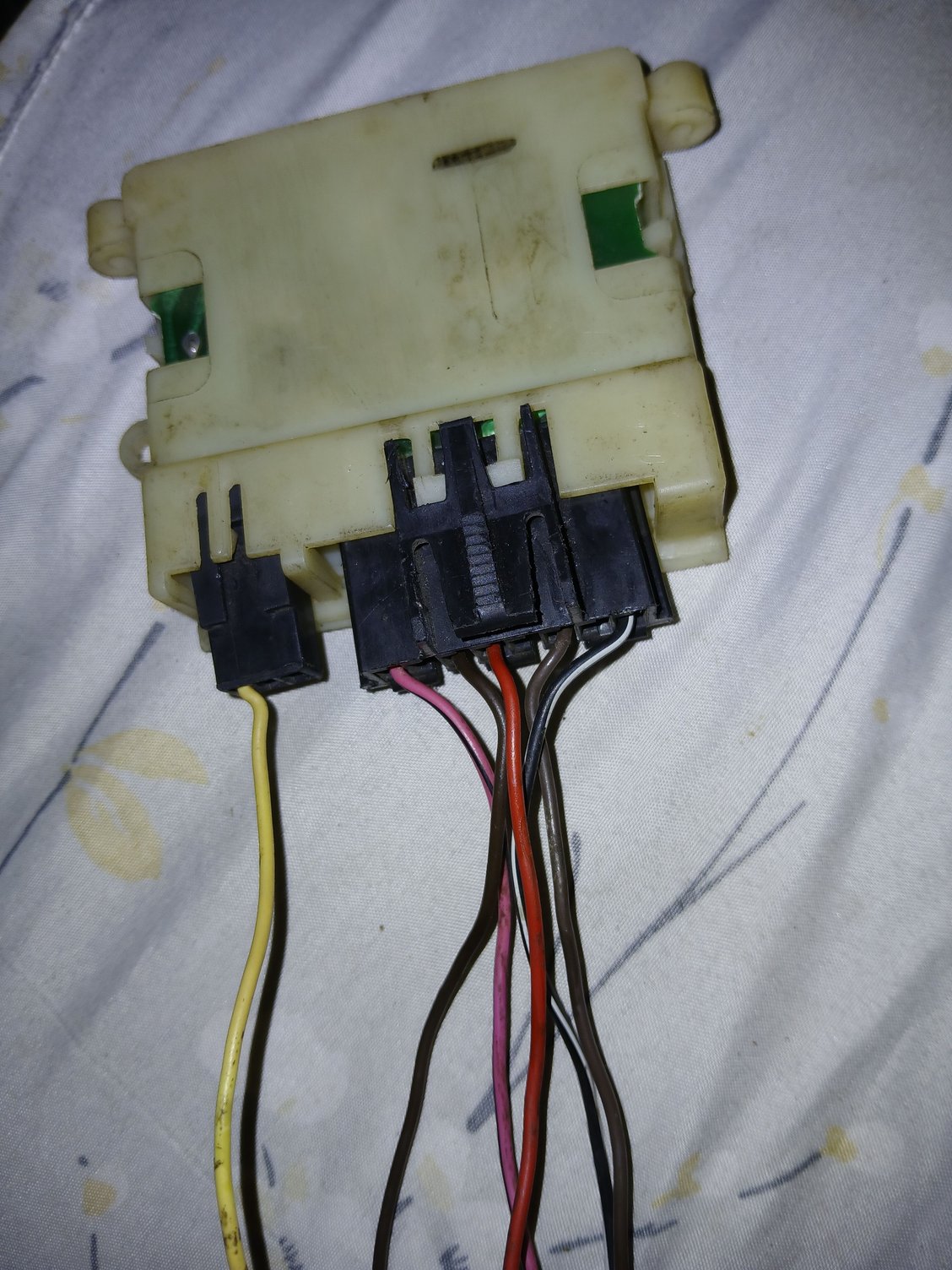

Need help identifying this component
Behinf
I swapped out the under hood and dash wire harnesst and the under dash harness from the 92 trans am 5.0 t..b.i t5 didn't have this component from behind the dash on passenger side hat my 92 formula 5.0 tbi t5 has. I'm having issues with no fuel or spark. Does anyone know what this component is and maybe this is what's causing the no fuel no spark issue. I can't find any info on this and even harder when I don't even know what this part is. Please can someone help with some info. thank you

Vss buffer, power to coil and icm ?

Thank you. Now I can move on and find out if this would fix my problem. Greatly appreciated.

the Vss buffer has no link to lack of spark and injector pulse.
