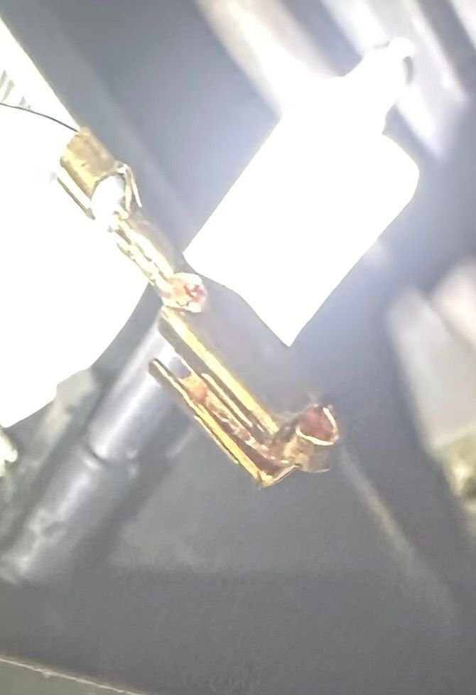

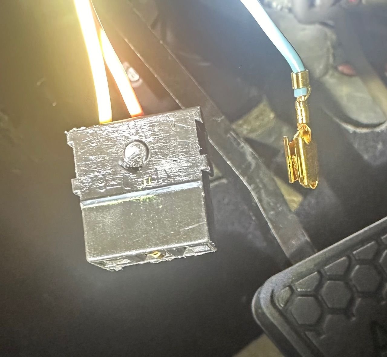

Can some one help identify this terminal? This is the brake switch connector from 92 Camaro. The replacement pigtail is GM 12117354 but I can't find a spec sheet.

That looks like a female metri-pack 480 series terminal to me. You would have to match up the width to make sure. Some parts stores have these or you can order from Amazon

Thanks! That was it! I acutally had a few sitting around.
