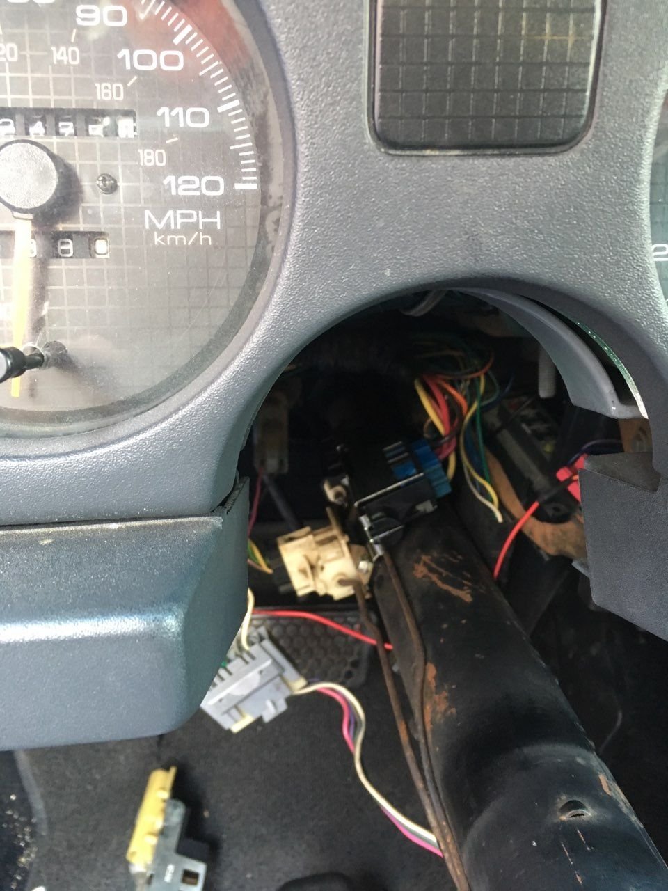

Only two possibilities here, either your ignition switch is out of adjustment, or it's contacts are all pitted & nasty(if everything else but the A/C works, I'd bet on pitted & nasty).
For clarity's sake, it's the black square on top of the steering column with the blue plug plugged into it in this pic;

Try adjusting the ign sw.
Lower the column. It's down near the firewall, on top, has 2 connectors with mostly big fat wires. 2 ¼" hex head screws (maybe 7mm in your year) hold it in place; loosen; slide the switch up the column a bit, maybe 1/8"; tighten; put the column back up. Lather rinse & repeat as necessary.
VATS is not relevant to this.
