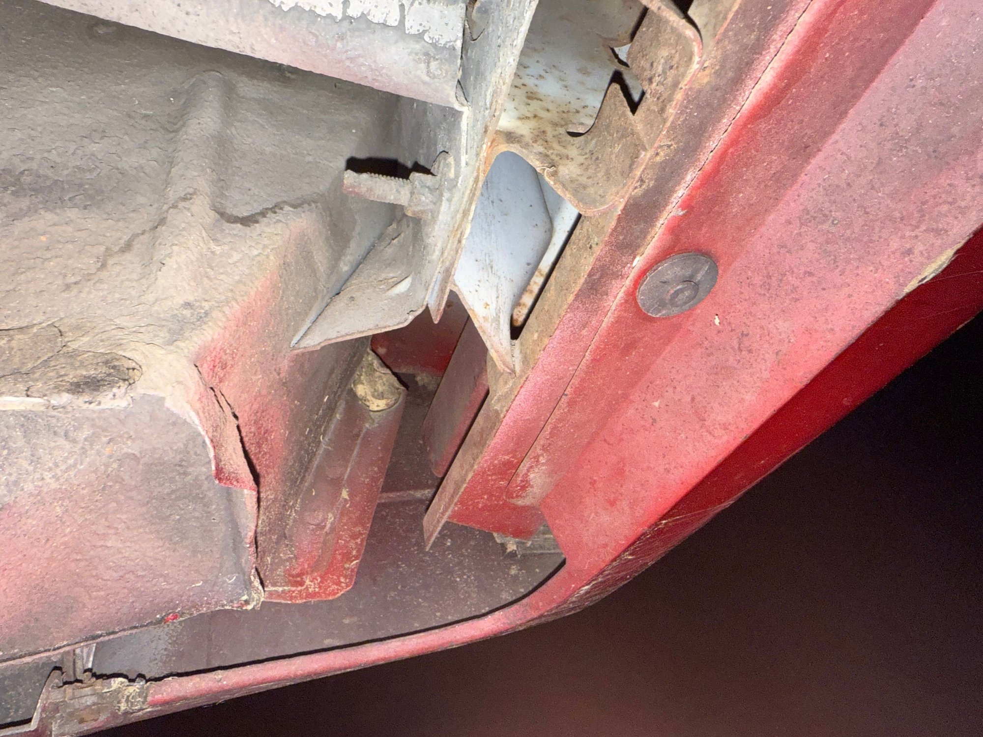

Thanks for any help in advance. So today I took it upon myself to weld up a new exhaust to my 2.8 liter (fuel injected). Here’s where the problem starts. I am extremely new to welding and working on cars and I welded the exhaust up to the frame to try it out (I figured if it drones or something I can just redo it) and I forgot to disconnect the battery at all. My car wouldn’t start after this and I had to charge the battery (which stopped charging at 62%, maybe unrelated). Then when I finally start the car something feels off. The exhaust sounds odd, it’s kind of a steady pulse of warm air now instead of a flow of hot air, it sounds more choppy like a vacuum leak and idles at 5-600 warm(video attached), and the starter isn’t really disengaging correctly, and when starting the car, the interior lights flicker! I’m wondering if im just paranoid and these things all happened before and im just now noticing because of the new exhaust install or if I really screwed something up.
for reference this is what the exhaust is welded to, the part with all the rust right behind the rear bumper

Did you weld the pipe directly to the frame?
