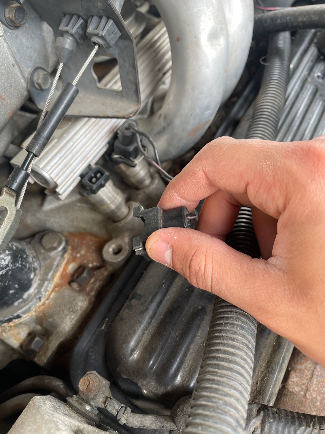

We going to skip all that stuff and verify that your car doesn't have factory installed Rochester Products Multec fuel injectors. They are retroactively defective by design. Each one of them is a ticking time bomb that will explode or has already exploded. Not literally exploded.
Take pictures of the fuel injectors and upload them here.

These are the pictures of the fuel injectors I’m gonna check the pressure today
