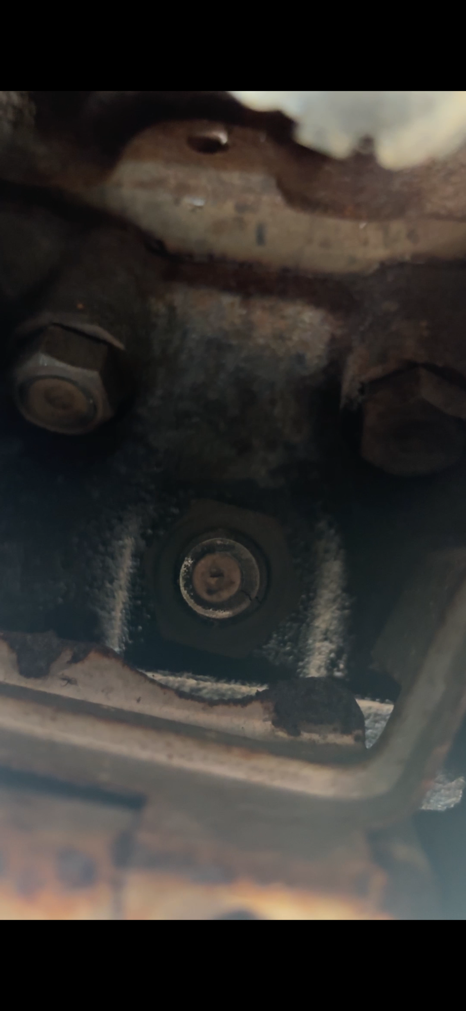

Is this it? I'm just struglling to visualize how you would hook a wire up to this. I didn't unplug any wires from the head when I was working on it either, so I don't know how it would have come loose. Do you have a picture of what the actual connector looks like? I'm sure it's just dangling in the engine bay somewhere.

Dark green wire, connector body probably used to be white; probably comes from the harness that runs up the driver's side of the carb, and over the valve cover from there.
Temp gauge sending unit is in the driver's side head between the #1 & #3 spark plugs.
