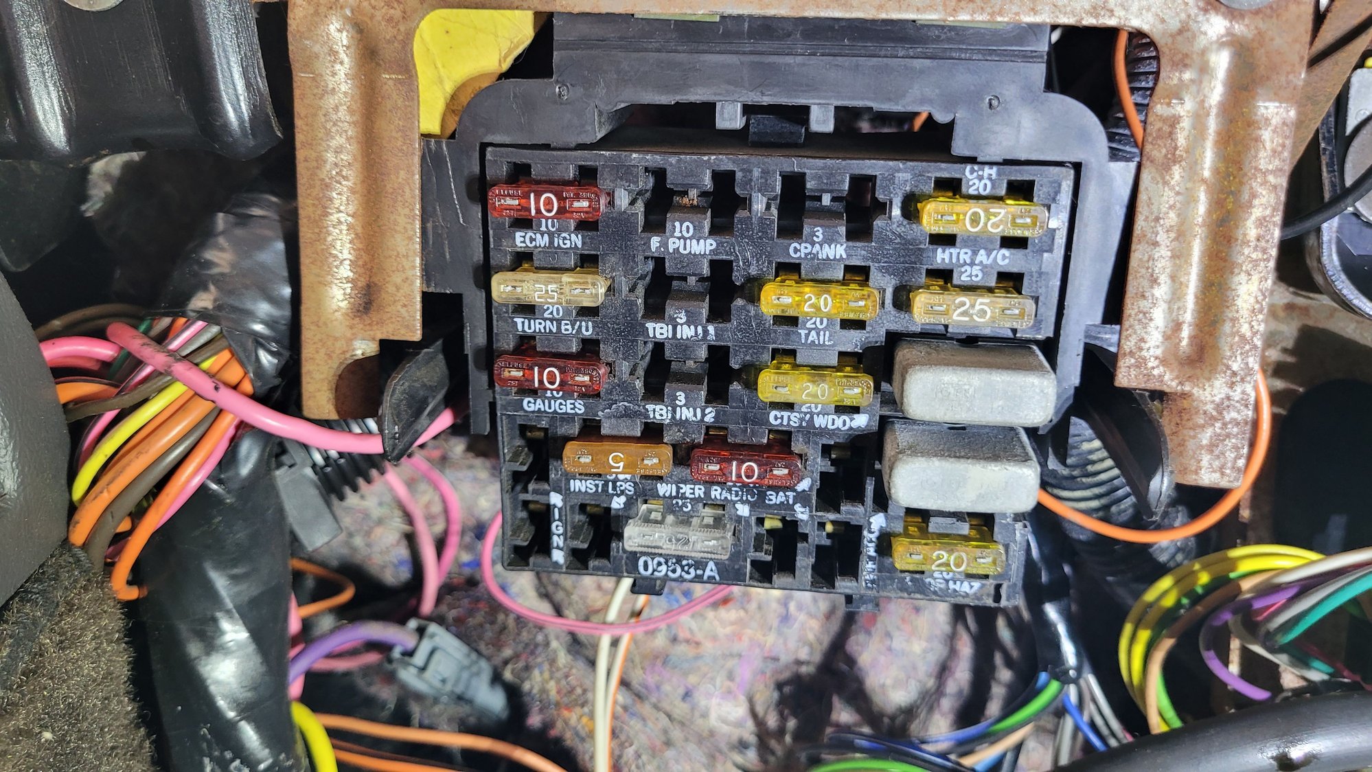

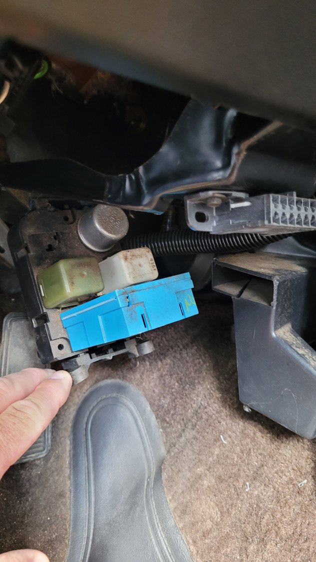

More fuse box talk sorry guys. We just got an 84 TA, v8 with Carburetor. Trying to figure out the radio power issue.
my question is if tf the fus3 box is missing any fuses. Also should have a pic of the other panel, convenience box. But it doesn't have any fuses.thanks

Your radio fuse is there. Have you checked it?
The convenience center has nothing to do with radio power...

radio fuse is fine. But haven't checked behind it to see if power is going through. The yellow on the radio factory harness isn't always live. The orange is completely out

Orange is the interior light & cig lighter clt. It also supplies hard battery to the tuner section of the radio to hold its memory. The radio won't work without it. It's labelled CTSY, as in "courtesy lights".
Referring to the labelling of the fuse that feeds that circuit...
