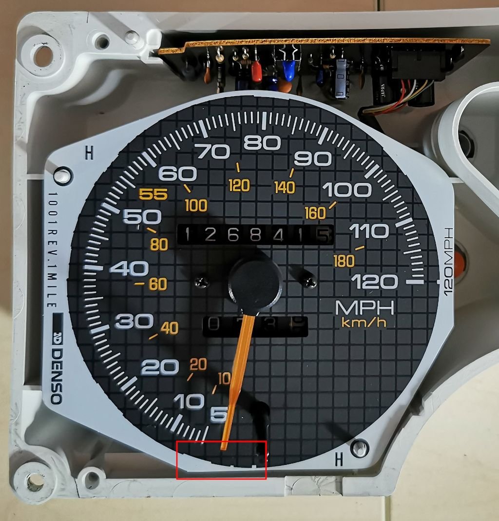

Well, yes, there is in fact sort of a zero mark.
it's SUPPOSED to be that tiny white mark in the middle down there, but I took note of the pointer position before removing it and it was never at that mark.
Put it back on just like this and checked my speed against the GPS afterwards and it is so perfectly spot on...
That would be my advice now: Go out on the road, go 30 or something according to GPS, then see what the speedo says, stop the vehicle and reposition the pointer as necessary.

I actually ended up doing exactly that. It's now within 1 kilometer of where the GPS is.
