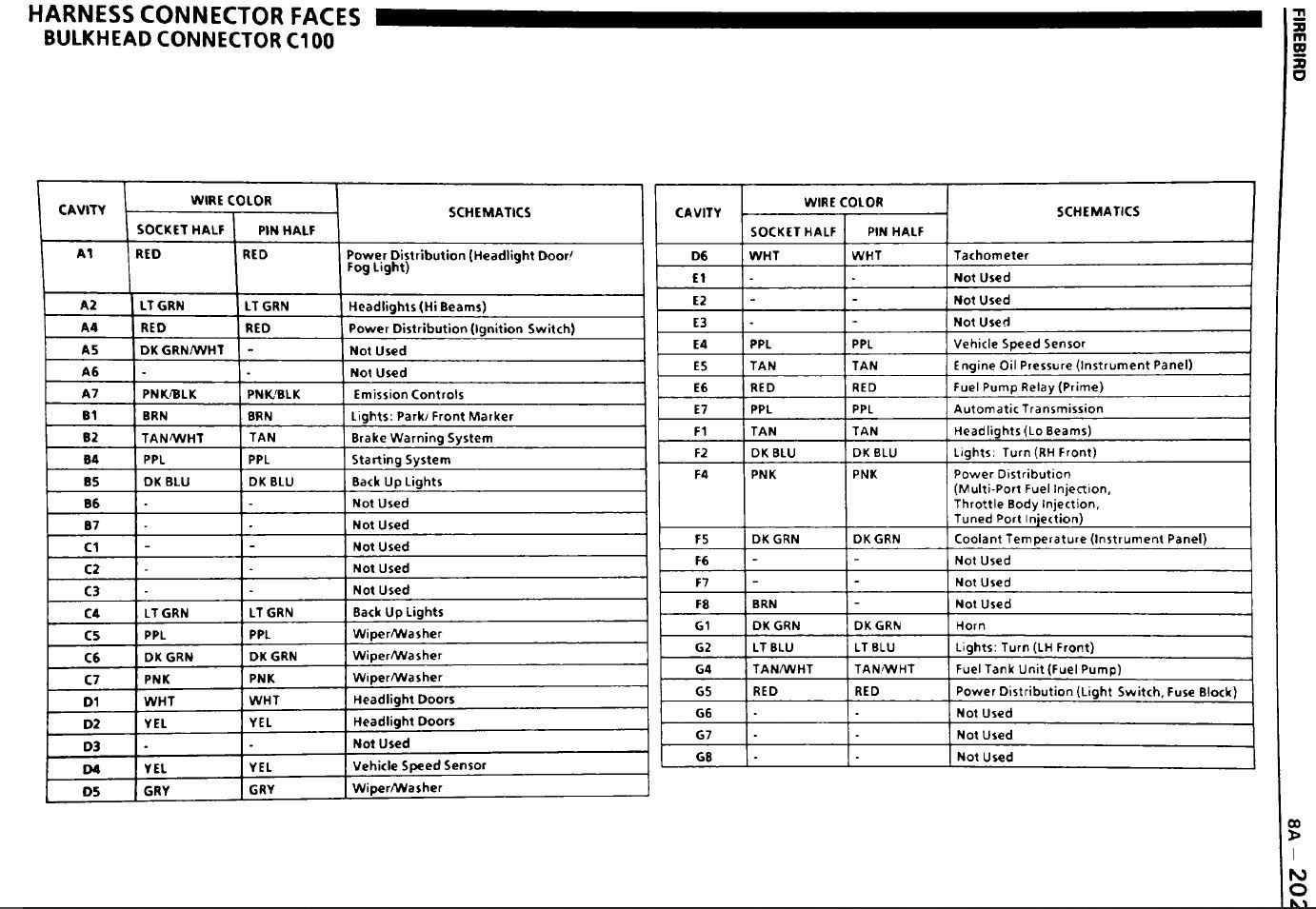

Does anyone have the C100 wire color code information for the harness 1989 firebird. I would like to remove everything that's not needed.
I found a diagram on Austin third gen but it does not say if its Camaro or Firebird would it be the same
Thanks Rich

shown on tgo as well as @John in RI site
https://www.berlinetta.info/C100.htm

I sent an email, looking for the C100 Diagram for a 1989 firebird v6 TPI I didn't see it on the list
Thanks Rich

no such thing as a v6 tpi, 2.8 ?

I am sorry it's a multi port 2.8

Originally Posted by J.C. Denton
Thank you so much !!!
