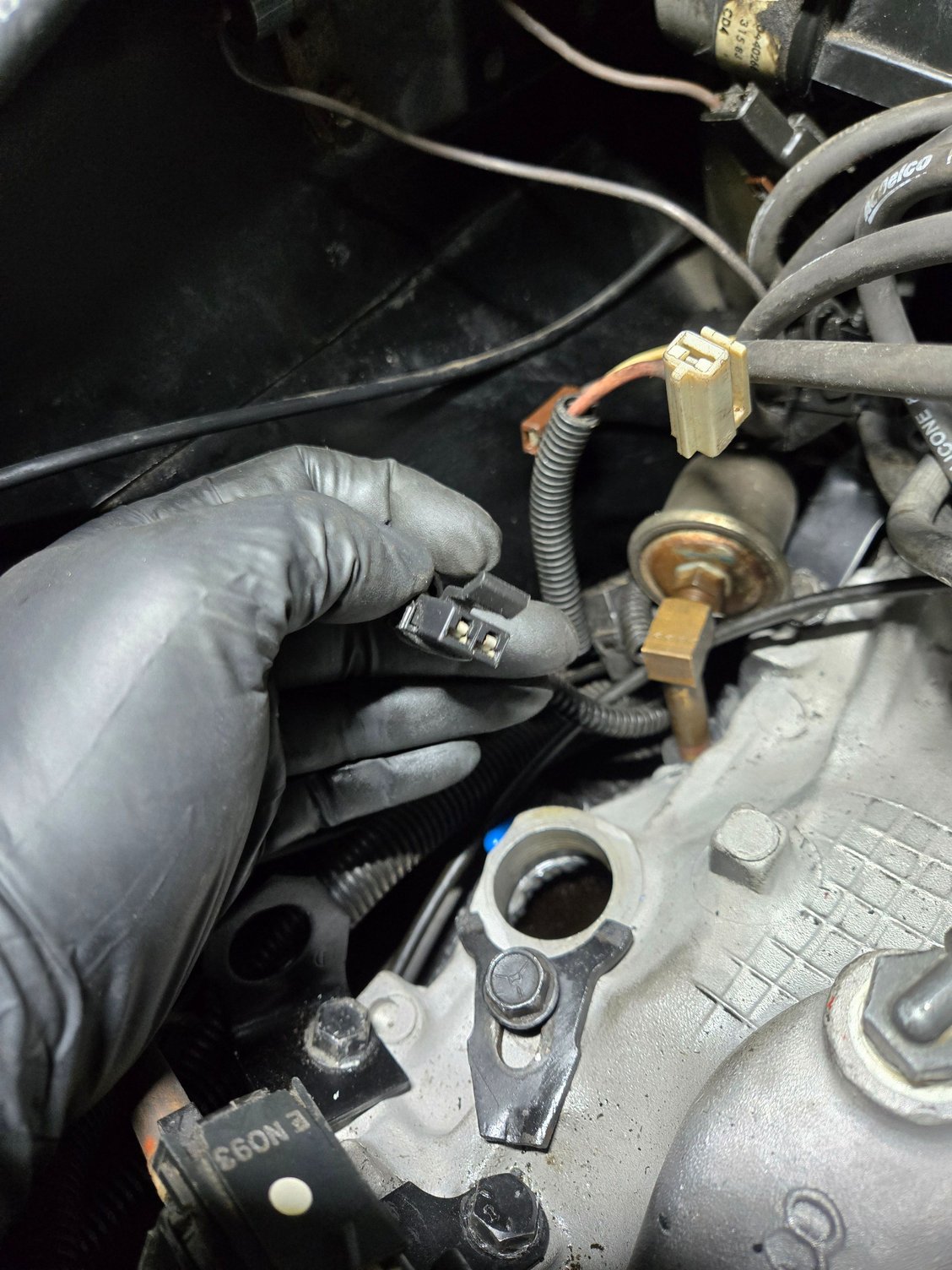

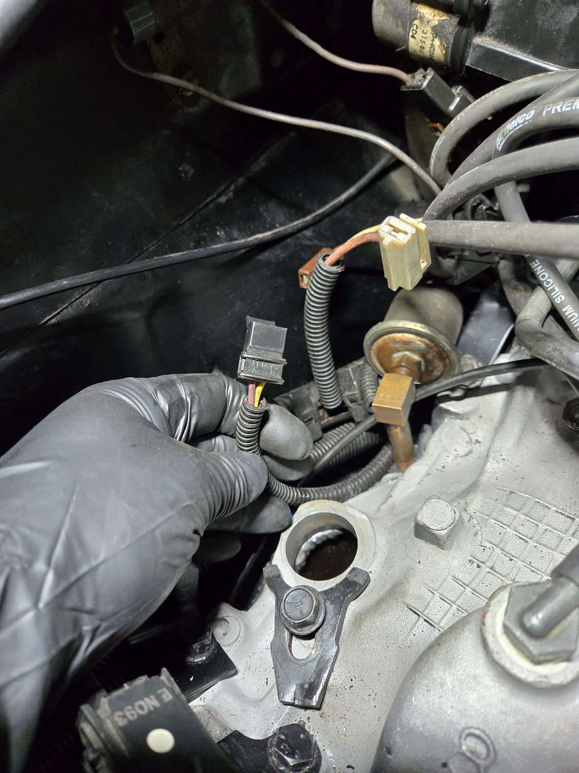

Need help in identifying harness connector. Working on a 1984 Camaro Z28 with the electronic carburetor. I removed the drivetrain to replace gaskets and reseal drivetrain. Upon reinstallation all connectors have been reconnected with the exception of one connector behind the distributor. It has 2 wires going to it pink and yellow. PED-16 on connector and pin identifiers A (pink) and B (yellow).

Looks like it could be the Windshield Wiper Motor power Connector...
I do not remember the early Wiper Motor Circuits very well any more...
But it would plug in to the Motor Assembly.

I really appreciate the reply. Yes you were right. The connector went into the bottom of the wiper motor. I didn't realize there were two locations on the wiper motor that had wiring going to it.
