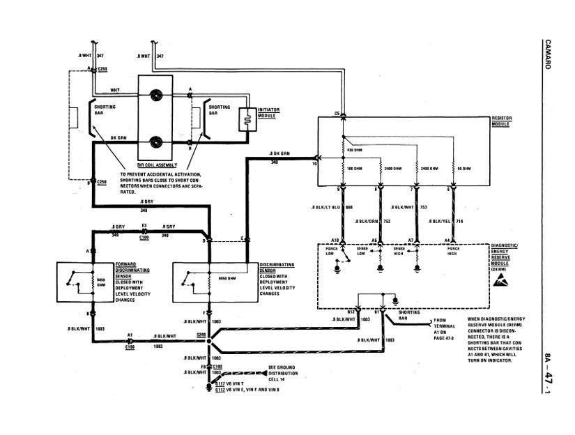

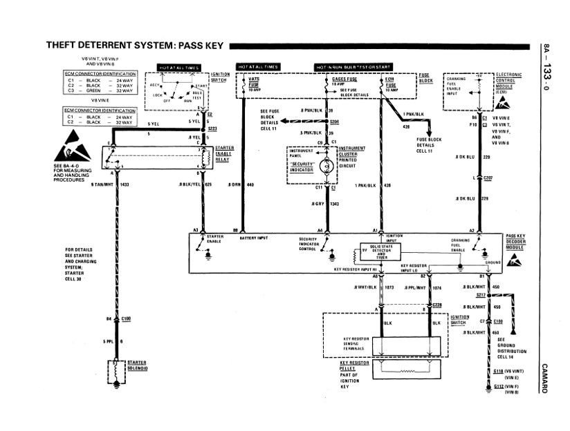

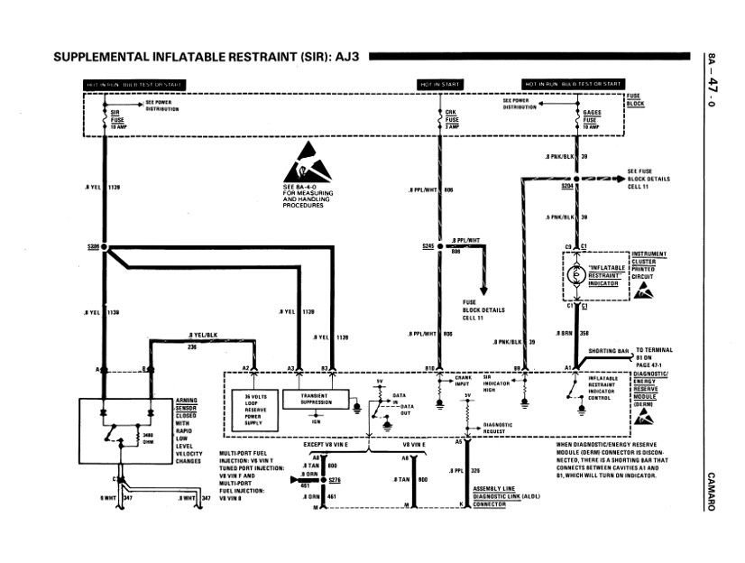

Re: body harness diagrams 91-92
These are for the SIR Airbag system.
This is for the Vats Pass Key system.
These are from the 1991 Camaro service manual.
