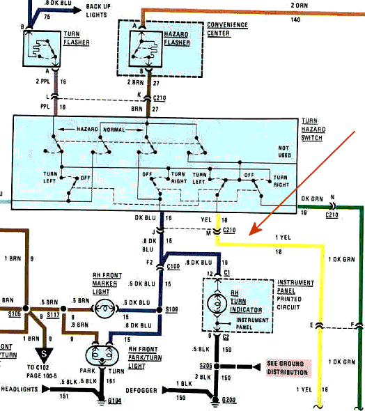

hi i need help with my left back blinker. every other blinker works but that one. and ive tryed different good bulbs and nothing still, ive checked all the grounds posible. and i even changed the shocket. and nothing , so like i think im not gettin any power to that one. if im not how could i run power to it to make the little turd work? so anyone please help.

From the looks of it, the wire in/on your steering column for that particular indicator is yellow, test & trace this wire..
(full image here.. http://92b4crs.tripod.com/86wiring/dia-pics/110-0.jpg )
