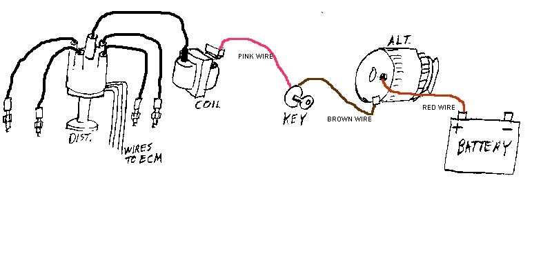

Just for giggles, I went out and opened the hood. I ran a wire directly from the Positive Bat. post to the terminal where the PINK wire connects on the coil. Then I jumped a wire from the big positive cable on the starter to the small screw with the purple wire hook up. (ONLY FOR A SECOND - becouse this engages the starter. My car started and ran. I have a V6 - w/ carburetor. But if you have a carb. your wiring should be simular. (I assume that you want to start it so that you can get it somewhere and swap that four for a V6 or a V8 - large car + small engine = poor gas milage, poor performance.)
If the motor has been sitting for a long time, the compression may be down - you may need to squirt some oil in the cylinders and let it sit over night to get the compression up.
I hope you are not stealing this car. (I hope U' ve got better taste than to steal a four cylinder)and AS ALWAYS any advice is AT YOUR OWN RISK.
I'm sitting here looking at the wiring digram for the 84 2.5 L engine and this is basicly what I see.

Oops! I made a mistake - you said an LG4. I was thinking, well never mind. Anyway the wiring should work, if Firebird kept the same color code and I think that they did.
The pink wire from the firewall should come off the key - that should be U're Pos. juice. Hope you've got it cranking already.
