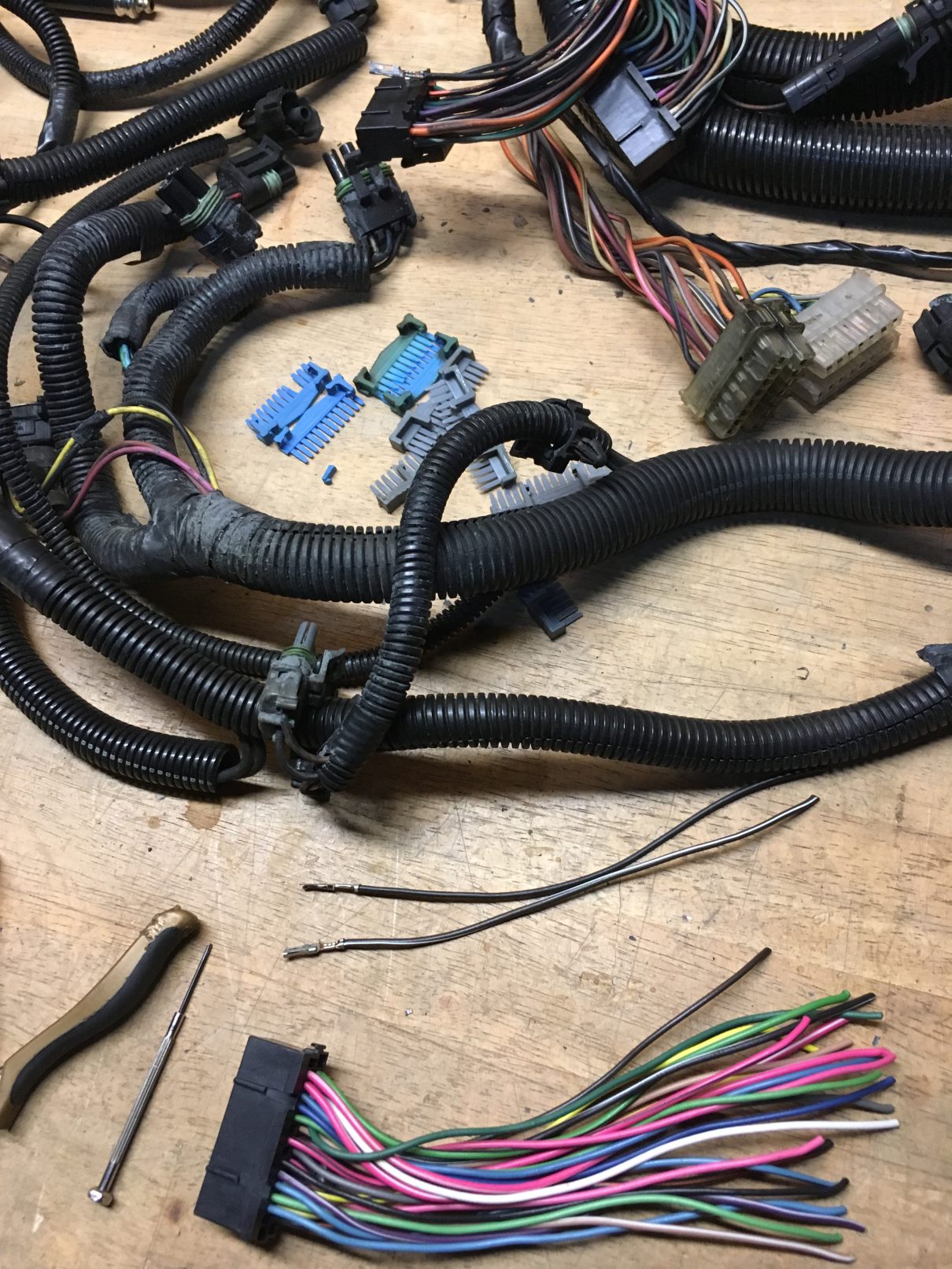

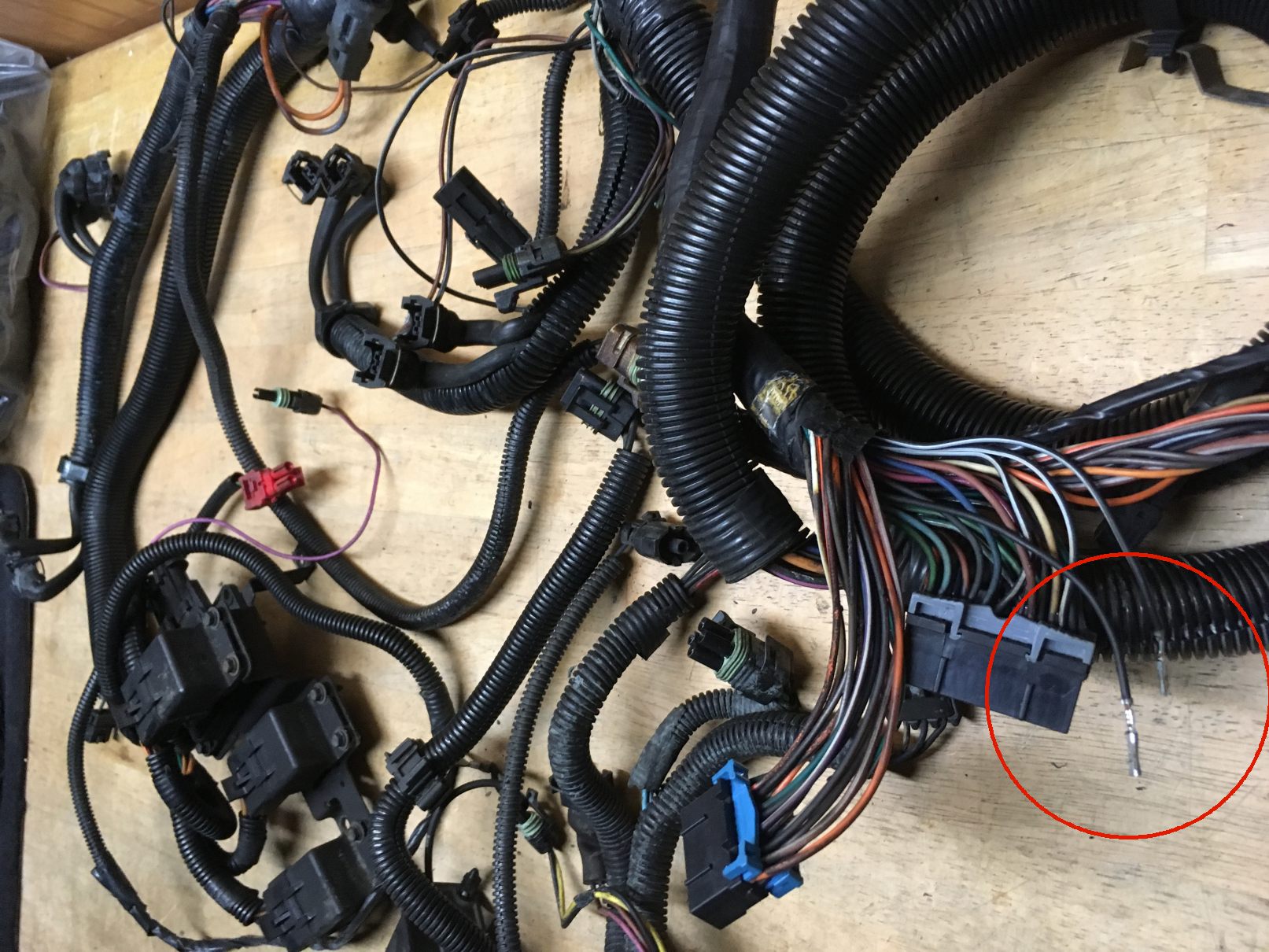

Hey John quick question for you i spliced the 2 grounds and that worked out fine i think im just trying to figure out what the name or purpose of this connector is, on the 2nd picture you put in this forum its the big plug one with 2 orange wires coming out of it, when its plugged in its behind and below the distrubutor

That’s the oil pressure switch , backup for the relay

Ok would the car function without this being plugged in ? I attached this plug but maybe I have it in on there the wrong way ? It was the only one I was concerned about

The one wire is hot at all times, might as well use. It can plug on either way on the 2 prongs of oil pressure switch.

Does that mean I could have it on the wrong way? Or are you saying it doesn't matter which way I put it on ?

It doesn’t matter
