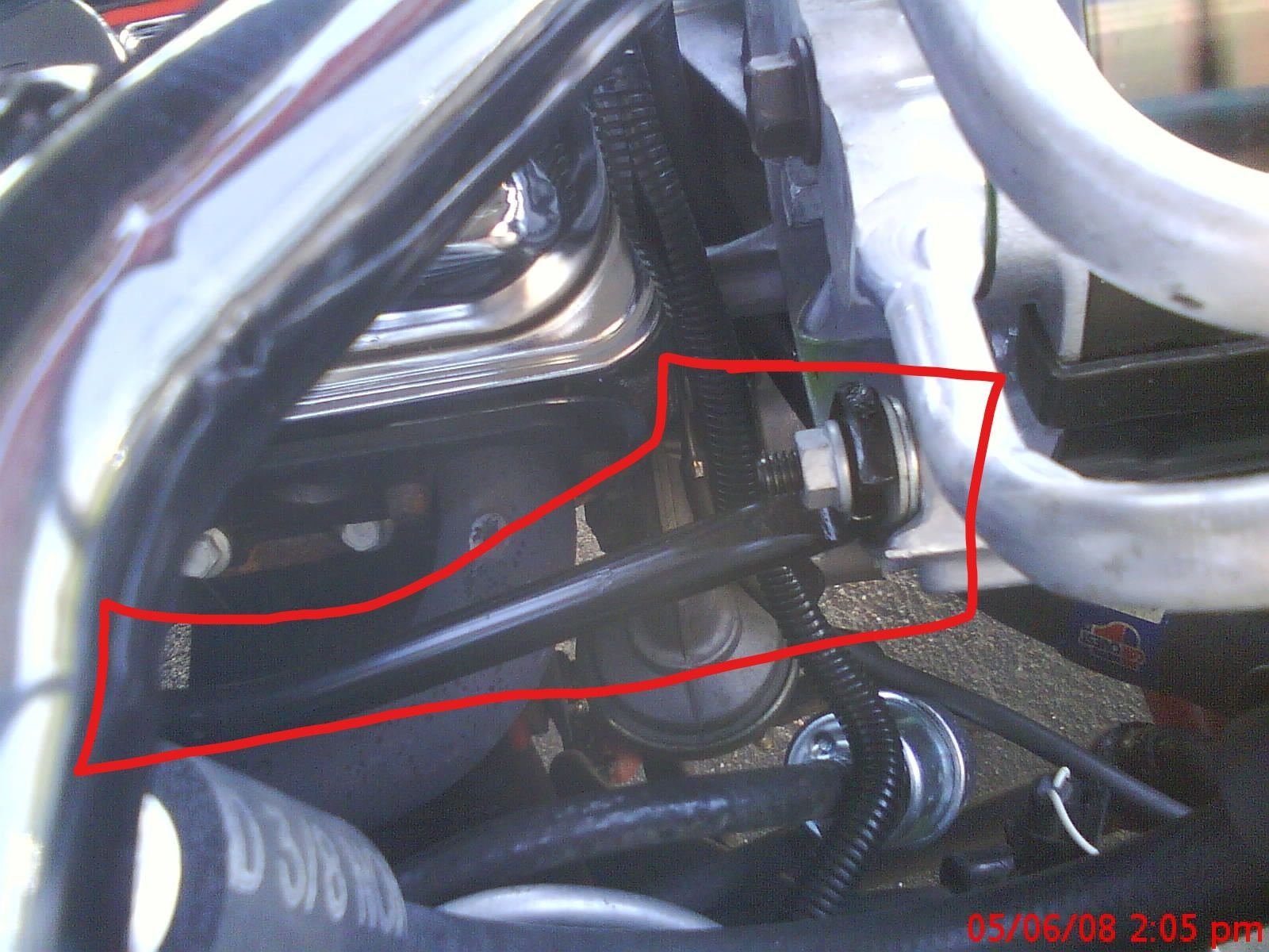

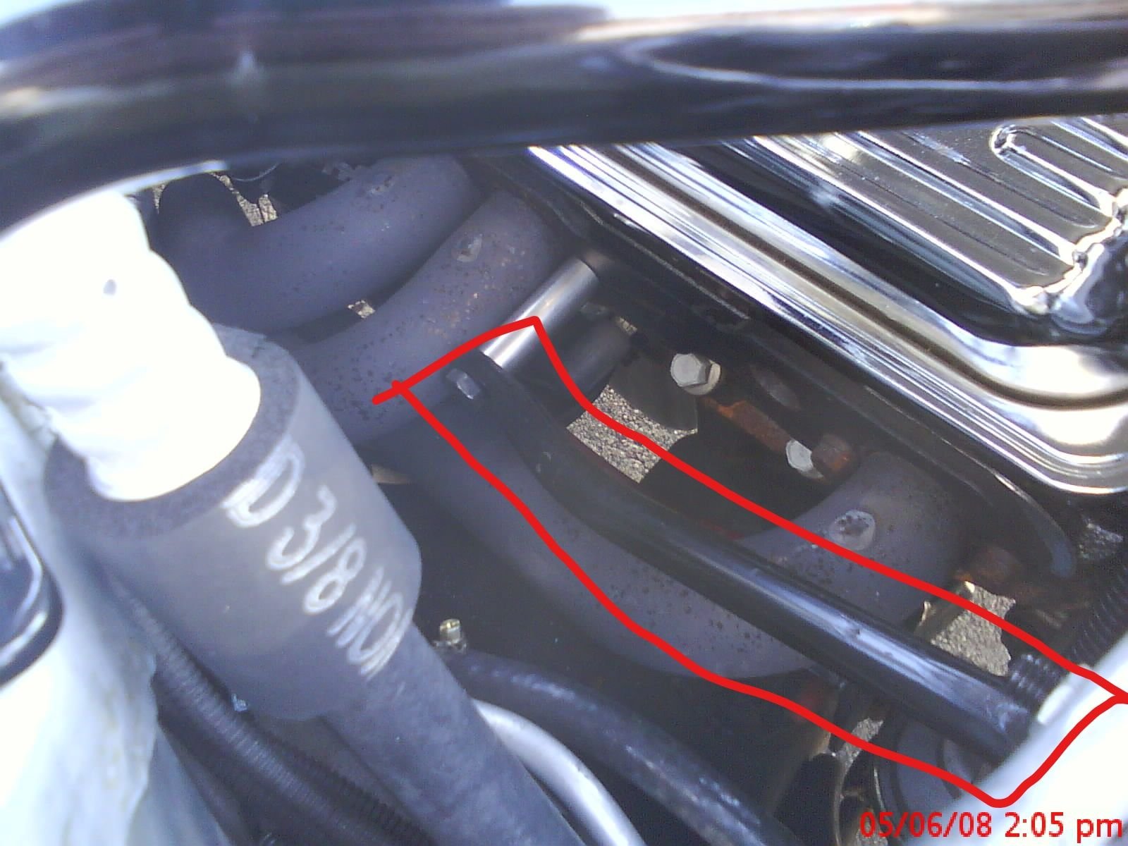

I'm looking for an AC Compressor bracket for my 88 GTA. When running A/C I get some vibrations, saw these pics on here.
It looks factory.

Yes, that's very factory.
Infact the early serp setups used 3 braces like that on each main bracket. Top ish, middle and lower placement.

Thank you for confirming, I always thought I was missing something there, I was also missing the alternator bracket that connects to the manifold. (luckily found a NOS one on ebay).

Bump, still looking for the little metal brace that goes from the back of the compressor to the exhaust manifold.

The above pics are from my serp set-up. The following pdf manual provides part numbers and installation info, which might prove useful:
https://static.atechmotorsports.com/...l-12497698.pdf
The kit didn't include the brace pictured below, which runs from the driver's side of the compressor to below the thermostat housing and in my case eliminated noise and vibration. I removed the brace from a 90+ car.

Thanks for that link! - I ordered that brace from GMPartsGiant - 10105267.
I'll have to go look around in junkyards for that AC to T-stat brace, it looks very similar to the rear Alternator-Manifold brace as well. I'll have to do some checking. I guess for now we can mark this post as good. Thanks for all the help!
