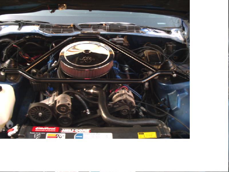

here is an AC delete pic
Attached Thumbnails Getting rid of the A/C-enginepic1.jpg

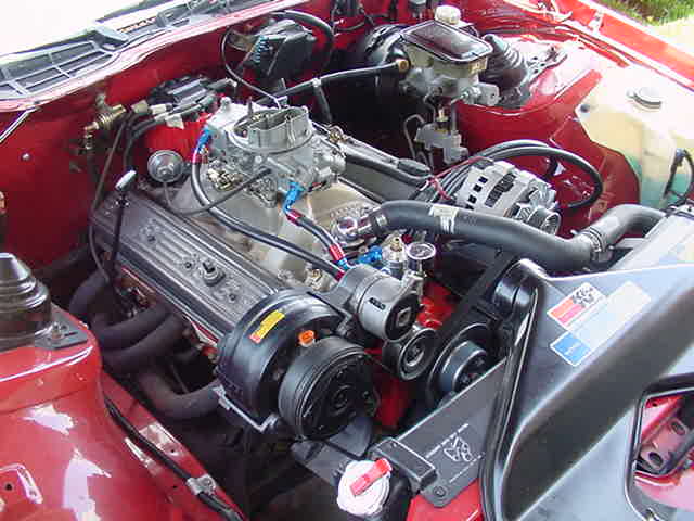

I cheated.
Attached Thumbnails Getting rid of the A/C-latest-engine.jpg
