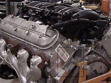

Old Jul 16, 2003 | 07:58 PM
wm_sorg's Avatar
Joined: Dec 1999
Posts: 954
From: Annandale, VA
Car: 1991 Formula Firebird
Engine: 2001 LS1 Modded
Transmission: 2001 4L60E Yank SS3600 TC
Look where the square is on the back of my engine. The number is perpendicular to the white tag.

Old Jul 16, 2003 | 10:48 PM
f-crazy's Avatar
iTrader: (-1)
Posts: 1,728
From: SE Michigan
Car: Bright Red 91 GTA
Engine: CARBED LT4
Transmission: MK6
damn so you cant really see it when the motor is int he car
