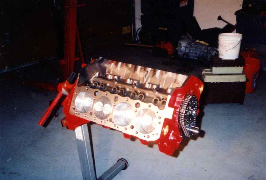

Finally got a couple pics of my 383 shortblock

Looks good... Where did you get it from or did you build it yourself? What parts are in it?

I did want to build it myself but decided to just buy a shortblock from Wheeler Motorsports. As far as the parts that are in it..there's a crank, some pistons, rods, bearings and a cam, lol. But seriously though, it has what they call a "Wheeler Crank" which is an overseas nodular iron crank that is supposed to be rated to 600hp...forged I-beam rods and forged Prode flattop pistons.

Sounds like a stout short block. What's the rest of the buildup going to be (heads, intake, CR, etc.)?

The heads are gonna be a set of 200cc Pro Topline with either 10.0 or 10.9:1 compression depending on which cc chamber head I get. The cam is a GM Performance parts cam that has 234/242 duration @.050 and .539/.558 lift (it think they got that grind from Crane cams) And the intake is gonna be a Holley Stealth Ram with 30lbs/hr injectors. I'm hoping to make ~450hp and ~500ft/lbs, what do you guys think?

I have seen that short block before.....did you buy it off Ebay?????
I have seen one listed there and if that is the same one you have, and it is reasonably priced, I am thinking about grabbing me one. Definitely tell us how it runs and surely how it holds up to a little abuse! Questions: one or two piece rear seal, and do you know if it is a roller block or not????

It is a one peice rear main seal. And yes it is a roller block, if you look closely at the first pic posted, you'll noticed the bosses for the lifter guide retainer.
