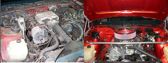

The engine itself, about $600 (canadian money)
The 350 was hideous, so the rest has just been things to make it prudiful

The drivers side wiring has every thing you need.
As far as my 2.8 > V8
Nice, self built 350 > 1400
Mounts > 20
Belts, Hoses, etc. > 50
Radiator > 100
Ignition stuff > 50
Built th350 > 600
Fuel Pump > 13
Dress Up Kit > 50
Carb > 200
Oil, fluids, etc > 100
Alternator, starter > 125
Flex Fan > 28
Headers, Ypipe > 180
Exhaust,
ypipe mods > 300
Freebies > Distributor, lots of hose clamps, coil, tach, oil dipstick.
I probably forgot many trips to the hardware or parts store for little piddly things.
This isnt a cheap swap, nor is it real easy. But, its not that hard, and if the car really means something to you, its worth it. My car drove me everywhere for 4 1/2 years, through a bad marriage, kid, college, and everything else. I couldnt just abandon her.
