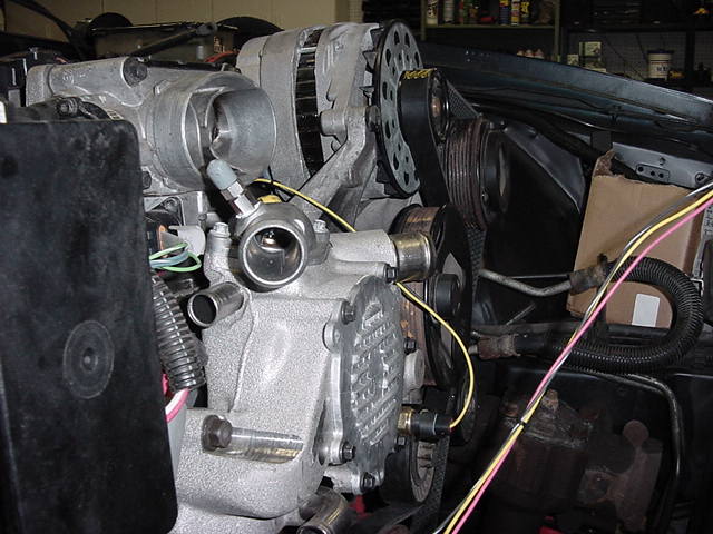

Thats my setup above...I'll have to send you some newer pics from different angles Texas.
You have to reuse the original mounts from the 3rd gen V8.
I can't recall off the top of my head how close it is but I know there are no clearance issues anywhere at all using the 'Vette accesories. Something must be wrong like Texas said...you probably have the mounts in the wrong place on the block.

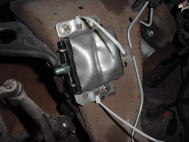

heres the mount to the frame:

there is only one place you can put them on right, its the same place i have put them on any onther v-8. right. or is there a diff place on the lt1 i didnt notice?

This is fuzzy but you get the idea:

Someone correct me if I'm wrong but I think there are two different places on the block that the mounts can attach. If you say yours is sitting on the mounts correctly, then you probably have them on right. they will only go on one way and actually 'meet' with the ones on the subframe.
