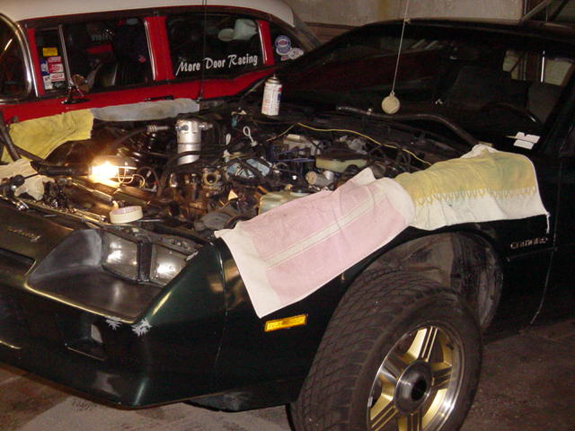

Work in progress - day 1.
(Need recommendations for a new air cleaner decal.)

Keep the decal on the air cleaner. Let the people looking at your tail lights figure it out.

Results after Day #2 - and confirmation for those wondering if you can pull engine & tranny with 2055's installed.
Day #3 - removing heads, getting things ready to take to those who can fix things I can't.
