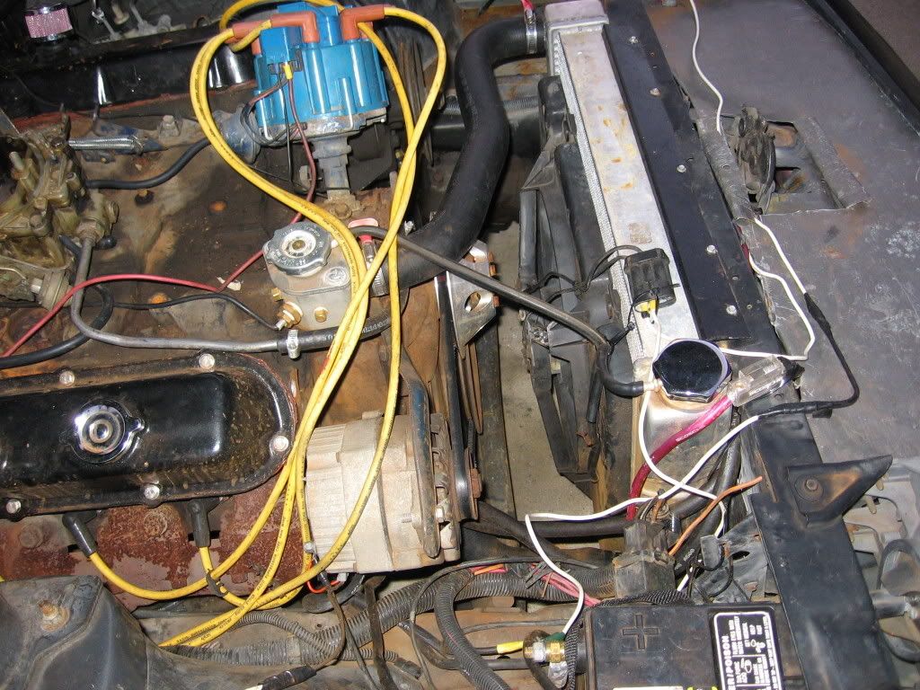

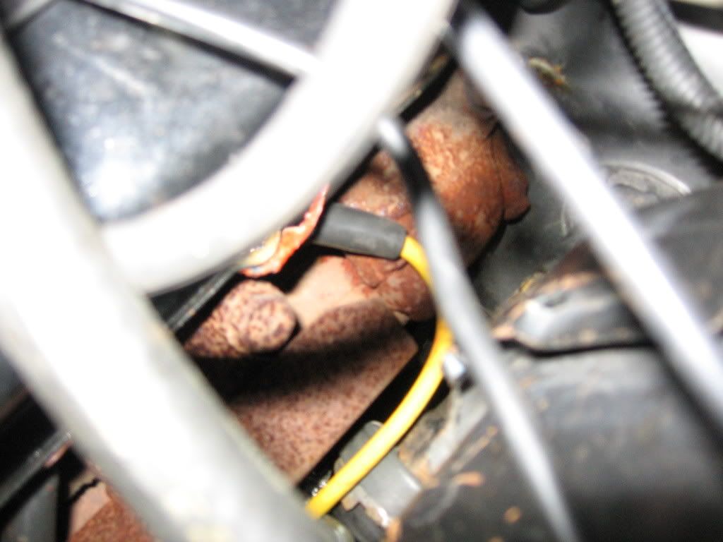

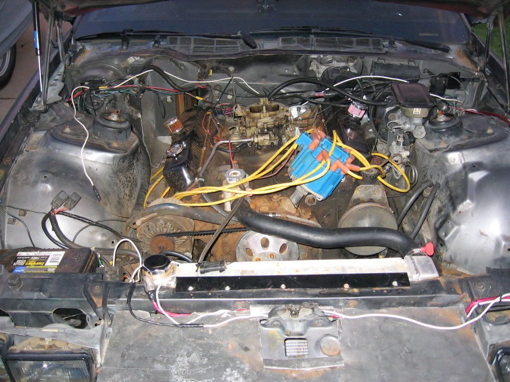

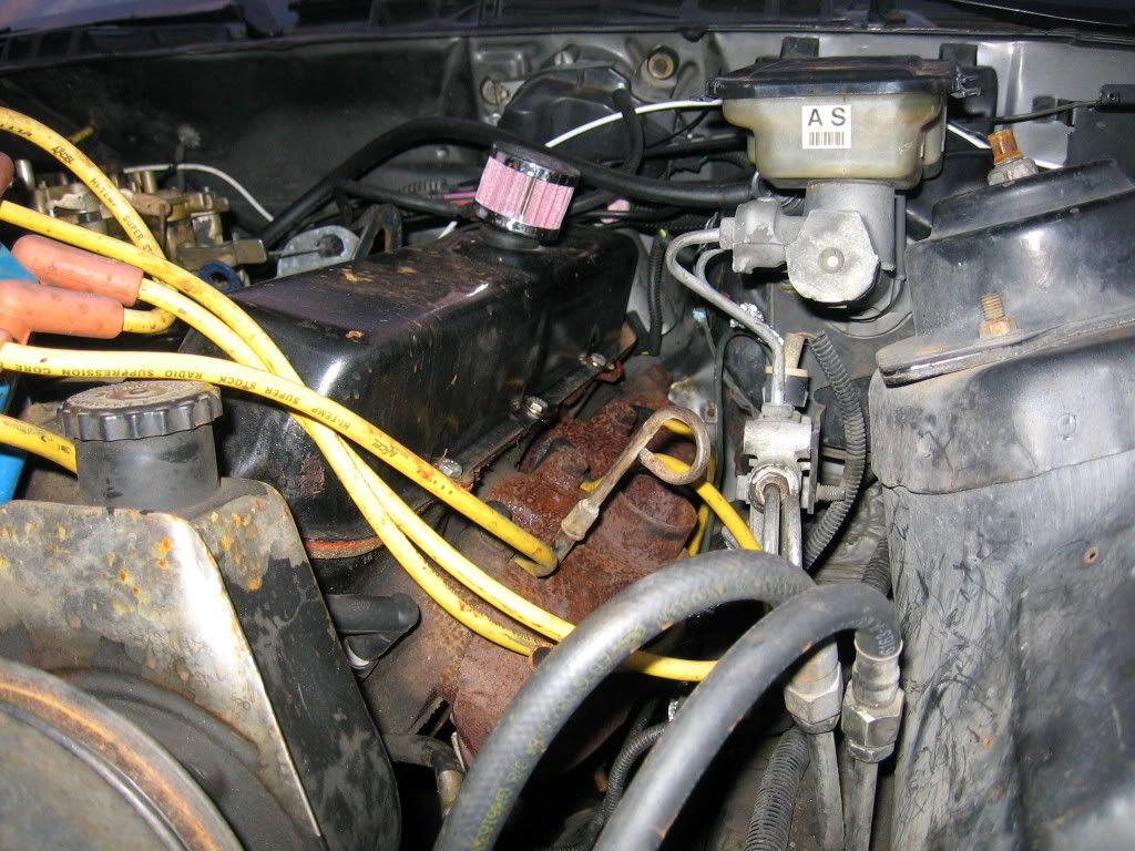

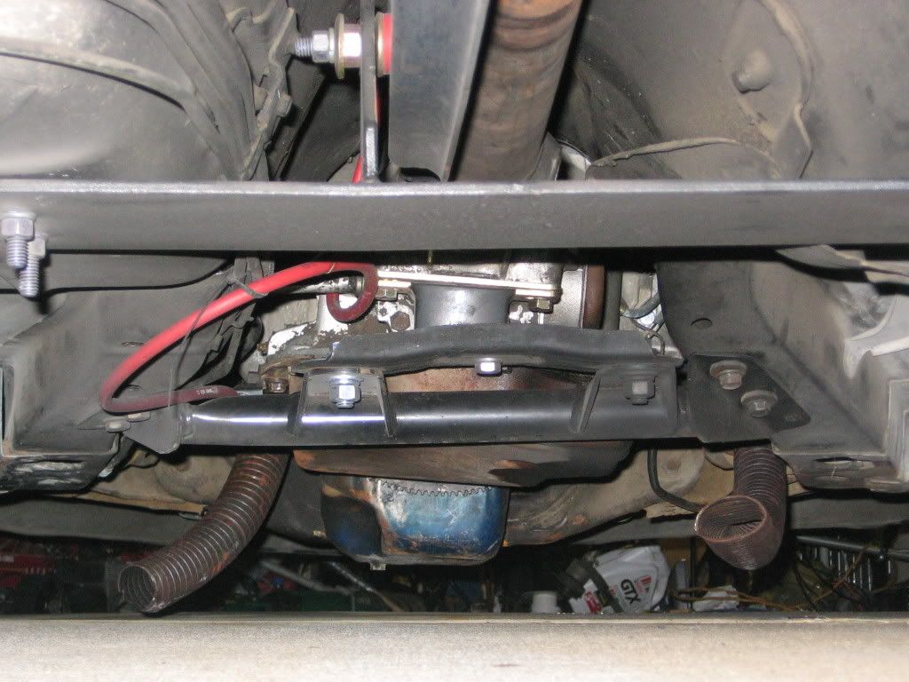

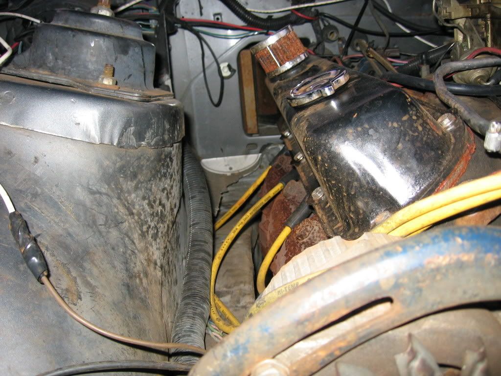

Project Dyslexia update: pics
here are the pics i promised everyone

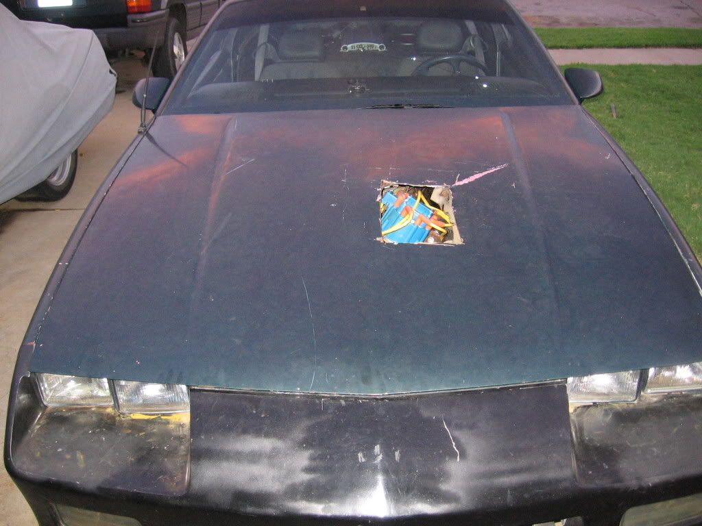

hole to clear dist. cap
pics of engine

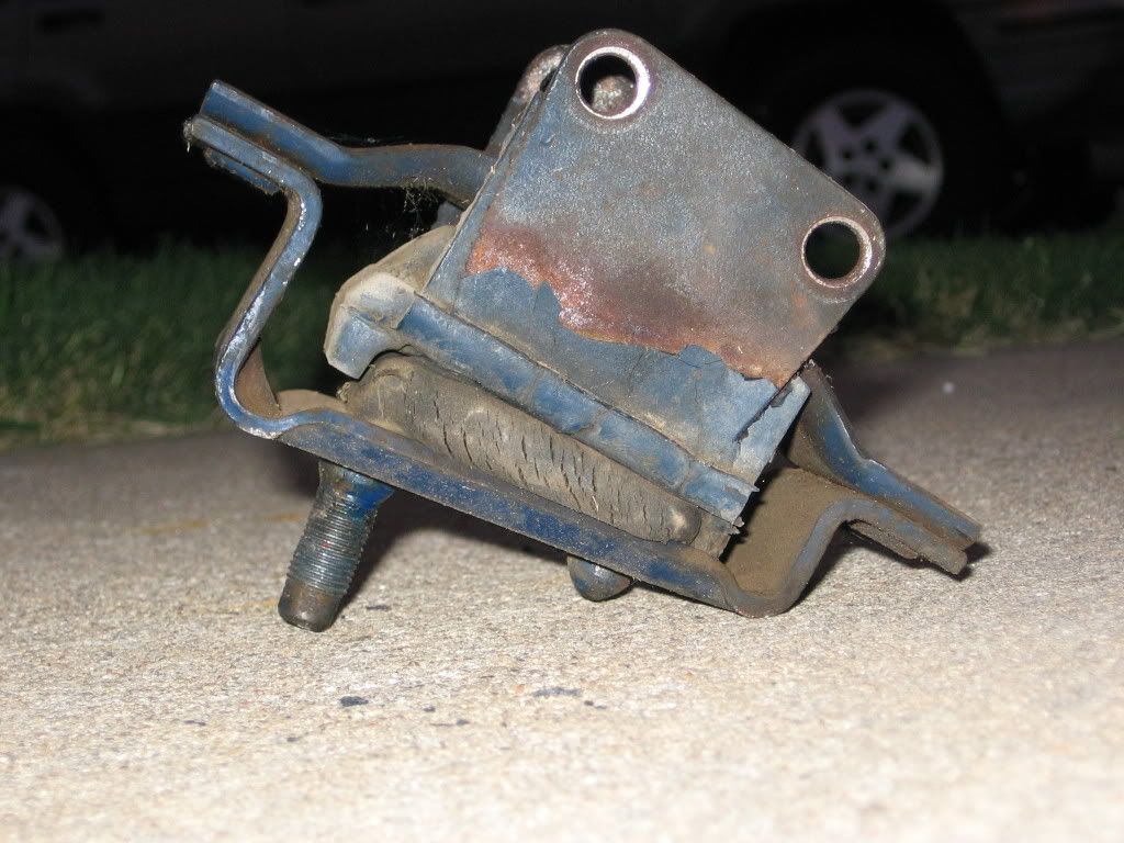

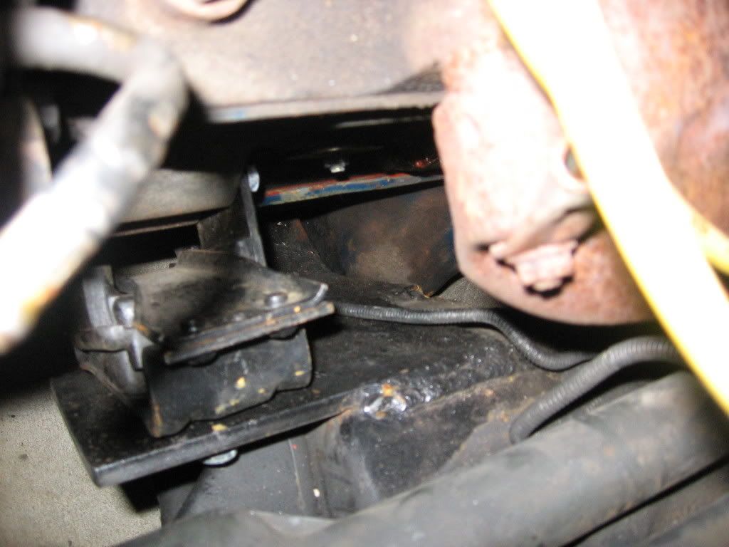

motormounts sit like this in car all one peice no top or bottom
plate welded to k member cuz caddy mount sit about 6" forward to clear fwd eldo trans
th400 crossmember and custom torque arm cross member

It looks like you need to add a formula-style power buldge!

car is gettin a 5inch pin on jongbloed when i get the extra cash....

Good to see you shoe-horned that beast in there. I remember when you shot that idea out there and naturally most people shot you down. Big props for pulling off an unusual and neat swap!

What's with that thermostat housing? Where did that come from?
Great pics! Thanks!
Now we need track slips!!
Your hood just needs a "bubble" for now!
I think they're 20 bucks from JC Whitney!!!!
Very cool car!!!!!!!

http://www.jegs.com/webapp/wcs/store...10002_14032_-1
its a moroso part ordered it through a local speed parts shop.
thanks for the compliments guys. if ayone wants measurements of the clearances id be happy to post them . it will help save sumone the all the hassles i went through getting the engine to fit ....

Re: Project Dyslexia
wow that a tight fit!
should have at least cleaned and painted it first.
love the cap thorugh the hood, congrats looks good

Holy oil pan to ground clearance Batman! Don't hit any bumps or you are going to put the crank into the road.

Yep, I think it may be skidplate time for you!!

sorry to say but you better straighten out that motor and tranny !!!! looks like its listing to one side

this bothered me for a while and after pulling the engine it seems that the plate that are welded onto the crossmember bent. driver side is bent up while passenger side is bent down. when i put it all back together i will weld in new thicker plates and some gussets so it can be straight again.
