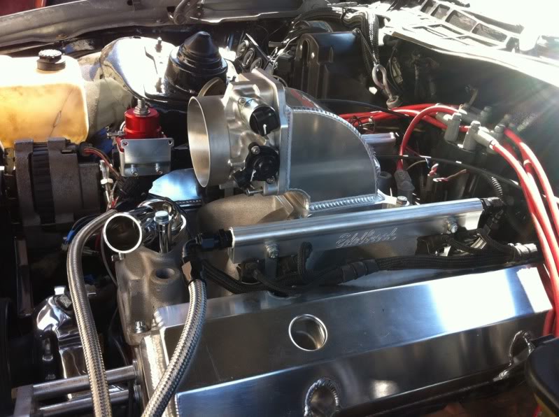

An update! such as it is...
Got a couple parts put in throughout last week. Lately its been a week waiting for a part, and 10 minutes installing it.
I rolled her out into the driveway and gave her a bath too
Throttle body elbow came in this morning. I have to do some machine work on it to accept vacuum ports and throttle cable brackets. As you can see in this pic, there's only soft parts left to install! hoses, cables, intake tubing, and a couple sensors and plugs. Soon I'll be

Old May 17, 2011 | 03:31 PM
  #53
gbayfisher's Avatar
Joined: Jan 2010
Posts: 820
From: Ontario
Car: 1987 Trans am GTA
Engine: D1sc 383
Transmission: t56
Axle/Gears: 4.11
Re: My 383 Swap Thread
Lookin good man....... Nice and clean!

Looks good. That elbow going to fit under the hood?

It barely fits. I measured twice tho The main goal was to keep the TB and it's throttle linkage from interfering with the water neck and FPR.

Definately a sweet looking elbow. Who made it?

The elbow is from Aaron at 6061.com. He has several different configurations and can prolly make anything you'd need. I just wish I could weld like that!
