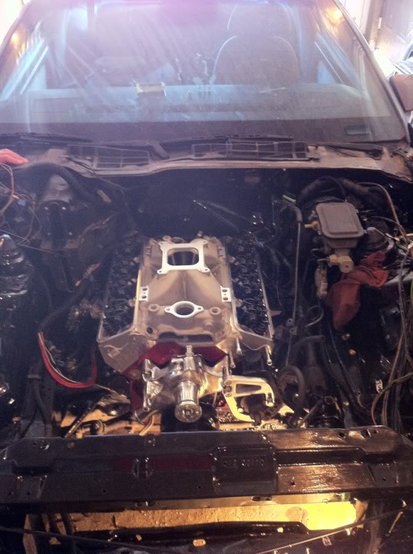

Re: My Motor Swap Thread
I absolutely hate that plastic convoluted tubing that comes covering all the wiring harnesses. I replaced it all with TechFlex braided sleeving. It makes the wiring harnesses almost disappear. Its a little more expensive, but its worth it IMO.
It was a little bit of a fight to get the serpentine belt set up. I had to custom make a bracket for an idler pulley. I think it turned out pretty nice.
After I got the accessory mounts figured out, it was time to drop in the motor. This was just last weekend
I put the TPI intake and factory exhaust back on for the first start and break in, then I'll swap over to the single plane. I need to buy bigger injectors and a fuel rail for the Victor manifold. This pic was taken to show the serpentine belt, after about the fourth try, I finally got the length right!
And that's pretty much how it sits now. I am waiting on my starter and valve covers, which should be here early this week, and I still have a few parts to bolt back on. First start should be Tuesday or Wednesday. I have to say I'm a little apprehensive. This is the first engine I've built, and I have a lot of time and money into it. I'd really hate to see it go BOOM within 15 min of starting it up.

Re: My 383 Swap Thread
Well I took the intake manifold off today. I still haven't found any reason for the noise.
I did find out that the spring rates on the valve springs that came on the AFR heads are 38# higher than the springs that comp recommends for my cam.
Seat pressure is the same, however open pressure is like 40# higher than the comps. Could that cause the lifters to be forced down every time the valve opens?
After stopping the engine, valves at full lift will close down quite a bit within a couple minutes cuz of the lifter plunger being forced down. I'm gonna call comp and see if they can't help, since I have all their components from timing set to rocker arms.
The next time I put an intake on this motor, it will be the victor. Anybody got a line on a 4 barrel throttle body for cheap?
Wow, I haven't done anything post-worthy in an entire week.
I made a call to Comp on Monday, they didn't have a whole lot to say about the noise. They suggested "burping" the lifters since there may be an air bubble in one or two of them, I tightened the locknuts down until the valves opened .100" or so, to force the plungers down, and I'll readjust the valves when I start it again. They also suggested running it at about 2500rpm for around 20 min. I haven't gone much past 2000 since I don't know what the tune looks like. Comp said my valve springs, while slightly heavy, shouldn't be causing any problems.
I finally ordered my missing steering column bearing, and put the rest of the column back together in anticipation of it getting here. Pretty much all that's left is the turn signal switch and the wheel.
I also ordered a ported stock LS1 throttle body and the appropriate sensors. I priced out my fuel line fittings, fuel rails, hose, and regulator, but that's gonna have to wait til next week to order. That stuff ain't cheap.
I'll have to make a "carb spacer" type of adapter to put the TB on the victor, and adapt some DIY CAI stuff from the parts store to duct the air in from the MAF for now.
I can't afford fuel injectors yet either. I'll crank up the pressure and abuse my factory 19# ones for now. Should allow me to get to 3500 rpm or so :-/
I also port matched my intake manifold to AFR's recommendations, leaving .050" all the way around.
Hopefully I'll be more motivated next week. Maybe I'll even put the front end back on
