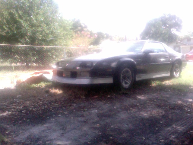

Here are some pics of my car. Ill take more if you need them

looks like an rs but no worries its still a camaro and no matter what engine is in there you can replace it with whatever you want hell im putting a duramax in mine

Do you want my vin number so you can personally run it and look yourself? Sorry about the sun thats like a couple day old pic was just trying to take one quickly thats why there all the same angle sorry. Why would I be messing with you guys? makes no sense...
Any way I dont understand why it wouldn't be an Iroc Z when both the vin on the car and the vin on the title match when I type in my vin thats what comes up 1988 Iroc Z... I know there is more than one vin on the car where are the others?

That's definitely just an RS. If you have that goofy rear spoiler those are somewhat rare. Not really desirable, but rare. Very unique.
Looks pretty clean, even though 2 of the pictures are awful, lol.
Is it a 5 speed car by any chance?
