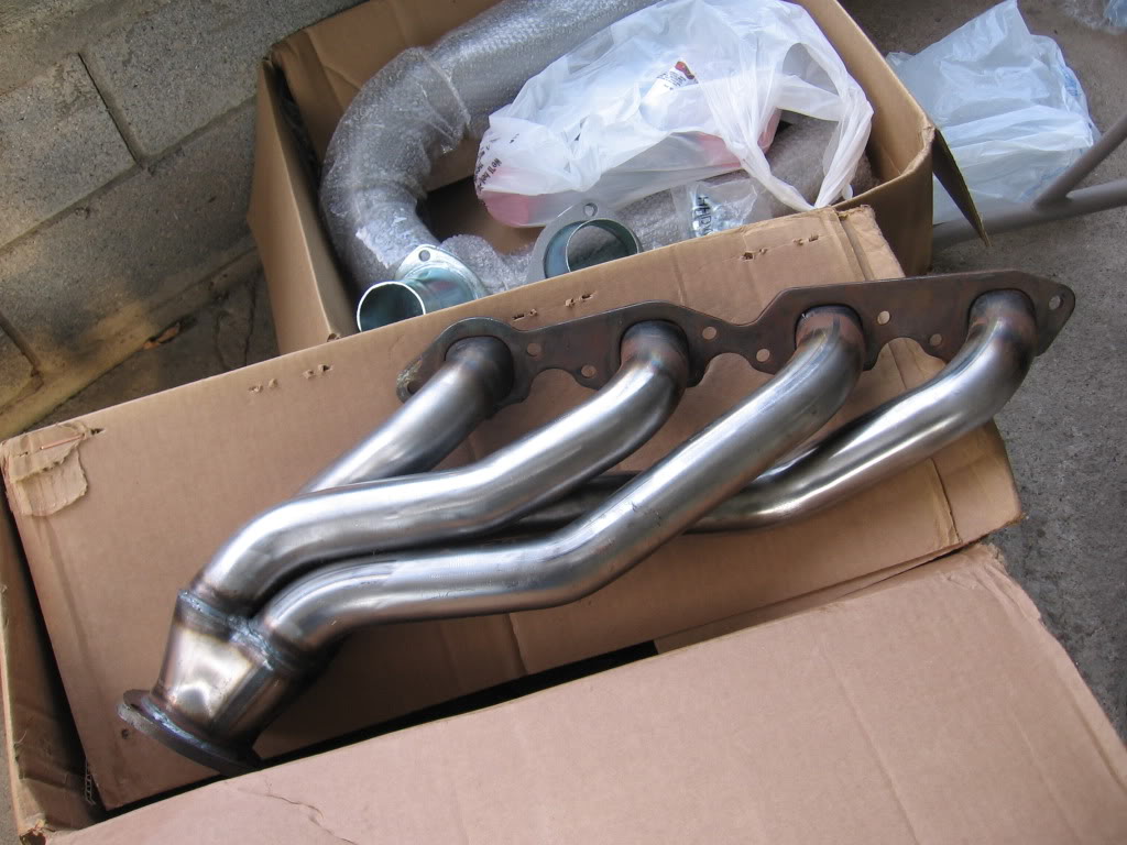

What kind of headers are those? Im planning on dropping a 468 into my 88 camaro and I still need headers, but those look like a set my buddy wants a hundred bucks for ?

they are patroit clipsterraw 737-h8013 also read threads onbbc swap headers where h8012 headers you do same thing fact i need to do little more hammer work i also am going to clip off where reducer bolts on off and weld 3" tube going by trans with 3" bullet mufflers
by the way cut off flang on pass side driversidefit great

Re: betsys big block returning
Easy as that???
Any BFH-to-floorpan // firewall persuasions??

read ithink big block swap headers itook bfh to floor likethey did onthat thread also dimpeled header at the clllector weld a little got to add little with bfh to floor willpost apic tommof header driver side was as easy as taking bar raised engine a little to get collector through thats it it fits great

Since ours will be a street driver, I am thinking of using 8100 truck exhaust manifolds. I saw the Ed Quay headers about an hour AFTER they sold!!..
Looking forward for more updates!!!..
