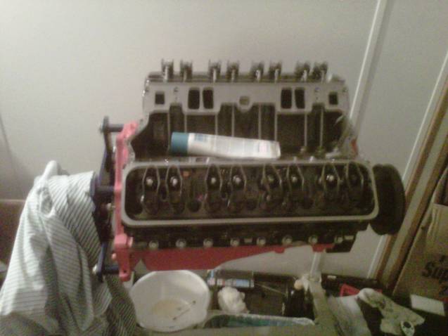

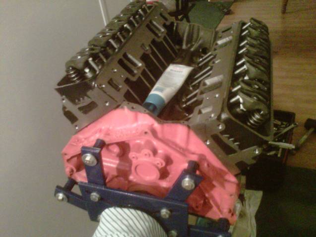

well between work, church,home, family and sleep I finally got a little work done and if things go right I'll have the 305 out of the car this weekend here are some pics of the engine. I got scared because I noticed after I got this far that the heads have small cylinder labels on them and that mark cyl. 3 on one head and cyl. 4 on the other so I panicked because of course I put them backwards. Then I looked at the ascessary holes drilled into the heads and seen that no matter how they are turned that the bolts still match and so do the exhaust ports. So now I'm not freaking out any more.
I guess I'm just tooo much of a rookie
Attached Thumbnails need a little help !!!-engine-pics1.jpg   need a little help !!!-engine-pics2.jpg   need a little help !!!-engine-pics3.jpg

ok I got the rockers preloaded (i think I got that right) the way I did it was I put the push rods between my finger and thumb and tightend the rocker until i could not move the pushrod easily or it stopped rotating freely in my fingers then I tightend a 1/2 a turn. And I did this only after bringing each cylinder up to TDC going by the directions in the book. this was my first time doing this so I ended up doing it twice the first time I got a grip on the pushrods and tightend down untill I couldn't turn them even using a pair of vise grips then I thought "wait that cant be right" and went back and studied the book and did them over.
While I have the valve covers off if someone has some advice please enlighten me this is my first time doing and I want to do it right. I think that I'm now on the right track. I'm going to try to have the 305 out today IF i can go home and concentrate on just that. Which is why I cut the grass yesterday!)

yep it sounds like you did it right, i always remembered intake open, exhaust close. that helped me. it sucks to have to do it one cylinder at a time. i would put the motor at tdc so it is easier to install the distributor. you will either be dead on or 180 out.
you will spin the pushrod in your fingers until you start to feel a little resistance(you will still be able to turn them just have a little resistance), then half a turn.

WHHEEWWWW!! THX man I appreciate the info. I was hoping that I did it right and that is just what I did. Now if I can get off work I'll finish putting the crossmember up on my homemade motor horse so that maybe Wed. if it is not raining I can pull the 305 out and start on the engine bay. then try to sand and clean up the valve covers then prime the oil pump and motor with the drill.

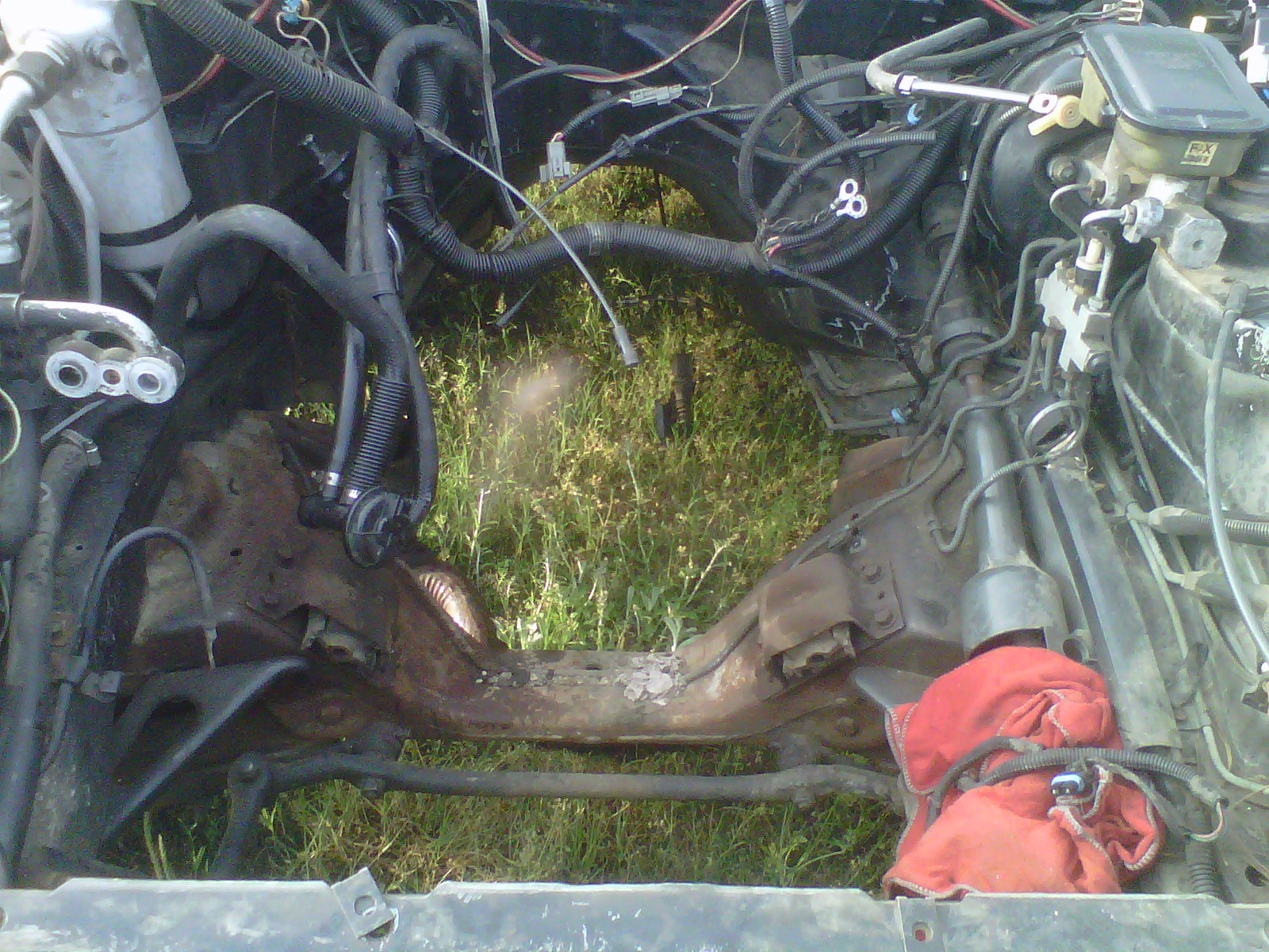

hey yall guess what, I got my homemade motor horse up and stable. I got my brand new come along on and working. I got my car under the 6x6's. and started taking it out and it came on up like a champ.
then I realized that I do not have enough room to get the motor and tranny clear of the engine compartment. So I have to do something to get enough room to clear the car. But I'll git it together. lol !!! see I knew that the car would raise up but I had no clue that it would come up that far it looks like a monster truck. so now I have to think of something that doesn't involve taking the entire motor horse apart (I'm not doing that) lol!!!! I have the poles 8ft hgh but failed to calculate the 1.5ft of room that the comeallong was going to take up and the amount that the car was going to come up.
can we say rookie !!!!!!!!!!!!!!!!!!!!!!!!!!!!!!!!!!!!!!!!!!!!!!!!!!!!!!!!!!!!!!!!!!!!

hey look i got it out

I need to know what I need to get rid of as far as wiring and lines and i will be trying to keep the elect. fuel pump that i have right now. with the return line. butg I need the excess wiring out of the way. once again I'm going to a carb'd vortec 350 and fp regulator. somebody help me out I appreciate it.

you will want a regulator that has a return port on it, and what i did for the fuel pump.. i took the wire, which is in the big loom on the driver side(gray wire) and took it straight to keyed ignition

ok i'll remember that right now it's wired to a manual switch in the ddash and worked with the key it primed up and everything.

Well its about that time I guess ill start taking the tranny loose from the 305 and take thhe serp assm. Loose from the 350 then find some bolts to screw into the heads to connect the leveler and come along. Ill have to take the carb off also while I'm at it I'm changing the front and rear seal in the tranny too.

ok got a rookie quest. I let the motor completely down and it is in fact resting on the motor mounts with the tranny hanging, waiting on the tranny crossmember but with all the weight back in the car the gap between the body adn wheels is still there i'll attach a pic of what I mean. is this 350 that much lighter than the 305 or is something wrong with my shock (which are prolly stock)? I knokw for a fact that all of the weight of the motor should be in the car (on the springs) as we know a dollar is 6in long.

The weight of the tranny helps some but I would think that the car may need to roll a few feet to see exactly what you have.

thx for the quik response. b/c of work adn church I don't/won't have alot of time to work on it for about a week but I will be trying to get the tranny all the way in and all of the acc. hooked up and the radiator back in and so on. ya know; trying to get it ready to fire up for the first time. I was scared that the shocks may have locked or something, idk.
