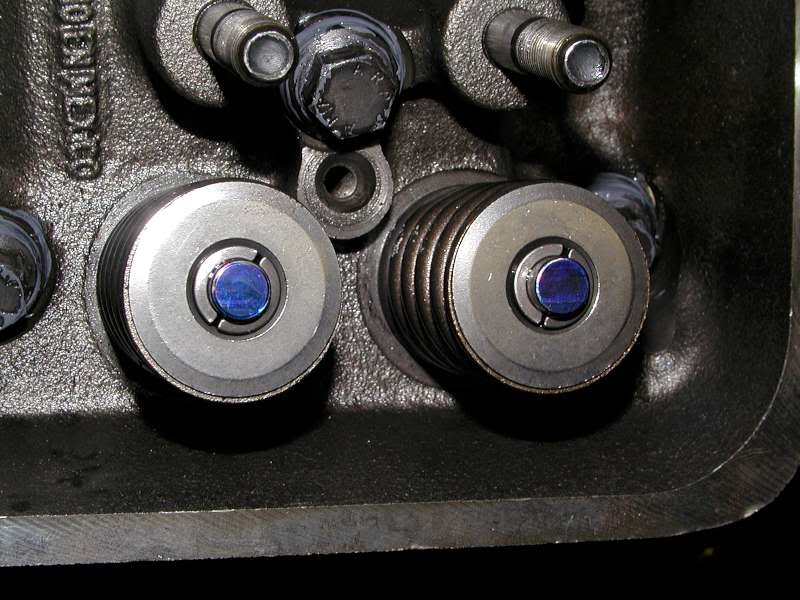

Tonight I installed a couple rockers to get the wipe pattern. Apparently 2 revolutions isn't enough to actually scrape the sharpie off the valve tips, but you get the point:
The rockers don't seem to be centered as well as I'd hoped, but the scrub marks seem to be pretty small. What's the opinion of the peanut gallery? Do I need longer rocker arms to get the wipe closer to the center of the valve, or is this good enough?

Hard to tell in the pic, but it looks like the swipe is on the outside of the valve stem. Correct me if I am wrong, but wouldn't you want longer pushrods, not rockers?

Shorter push tubes will move it closer to the intake side of the valve stem

Matt, you lost me.
Wyo, I need shorter pushrods to pull the sweep closer to the intake? I guess my little imaginary diagram in my head had me thinking that a taller pushrod would tip the rocker arm down more, which would pull it closer to the intake. I guess it depends on the angle of the rocker compared to the valve.

I just went through this with installing 1.6 roller rockers and had to move the sweep in and took 1/4 inch shorter push rods

THAT much shorter? Wow. I've got a set about 1/4" shorter from a roller cam motor. Maybe I'll give those a try.

My rollers were like almost off the tip of the valve on the exhaust side

I got the comp cams pushrods checker and it was off that far

Tonight I went through the process again with shorter pushrods. I had a set that came with the vortec heads that originally came off a roller cam motor, so they were about 1/4" shorter than my original rockers. The results were rather surprising.
Overall, things didn't change much. The rocker tip is still pretty close to the exhaust side of the valve.
Here's a repeat with the PRW 1.6 rocker and my original pushrod:
I repeated with the shorter pushrod, and as you can see, it's not a lot different:
For a reality check, I put the stock rocker back in, still with the short pushrod. Not surprisingly, the wipe pattern is wide, but it looks like it's a little closer to the center:
Lastly, I put the stock pushrod back in with the stock rocker:
All of these are favoring the exhaust side. What surprises me is how minimal the difference in position is from the stock pushrod to the 1/4" shorter one. I really expected it to move more than it did. I really can't imagine what would cause geometry to be so far off that I'd need to go to a pushrod that's 1/2" or more shorter than stock.

Are you using a solid lifter or hydraulic? Hydraulics compress and can mess the readings. I usually use an old lifter that I convert to solid with some washers to measure my pushrods.

this kinda confirms what i thought about 1.6 ratio rockers though (and the reason i don't use higher than stock ratio rockers normally...)

Kevin, it's a hydraulic, so yeah, it's compressing. I thought about throwing a checker spring in, but all I'd really expect that to do is extend the width of the wipe pattern a little bit due to the additional lift, but I wouldn't really expect it to have much effect on the position of the wipe pattern relative to the center of the valve stem. Or is my thinking off base?
Matt, I'm not quite ready to blame the rocker yet. The stock self aligning vortec rocker is heavily biased to the exhaust side too.

The fact it compresses makes it act like a much shorter pushrod than it really is. Personally if it were me I would get an adjustable pushrod and make a solid lifter out of an old one (or use checker spring). Measure your pushrod after and order accordingly.

Made a little bit of progress over the last couple nights.
Last night I started porting the runner side of the intake. I went as far as I could until I ran out of sand paper cartridges. Like everything else, nobody sells them locally so I have to order some and wait for them to get here before I can finish cleaning up the intake.
While I'm waiting for cartridges, I decided to work on a couple other things. I mixed up some JB Weld to repair my injector bosses and the one spot on the runner mount that I went through when porting:
Since that's taking my intake out of commission while it dries, I went back to the motor. I replaced one of my valve springs with a checker spring and checked my wipe patterns again.
Here's the pattern with the stock 7.8" pushrod:
Here it is with the shorter pushrod:
I think I'm just going to go with the shorter pushrod set. If I go any shorter, even though it might move my wipe pattern closer to the center of the valve stem, it just winds up with too short of a pushrod.
While the spring was off, I snapped a pic to show what the SDPC modification looks like. As you can see, they cut down the valve guide boss and use an aftermarket valve guide seal:
