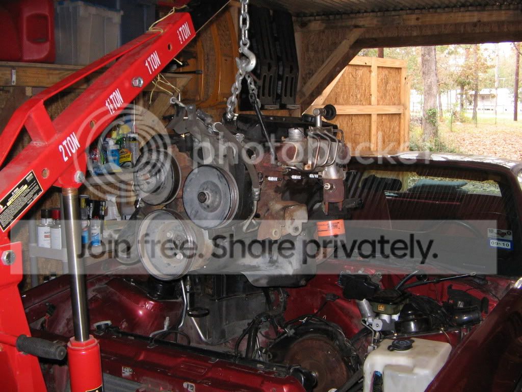

Old Jan 27, 2013 | 08:54 PM
ex-x-fire's Avatar
Joined: Jan 2011
Posts: 1,732
Re: 305 TBI to 403 olds
This guy got one installed, looks like headers fit. Most likely block hugger type headers.
