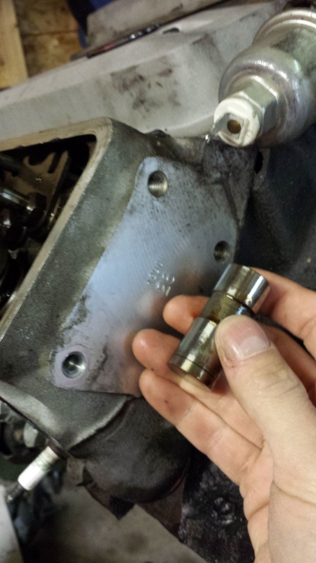

Re: 86 vette 350 into 92 z28 305 car
flat tappet on the valve cover
about as aluminum as it gets . magnets dont stick to it
