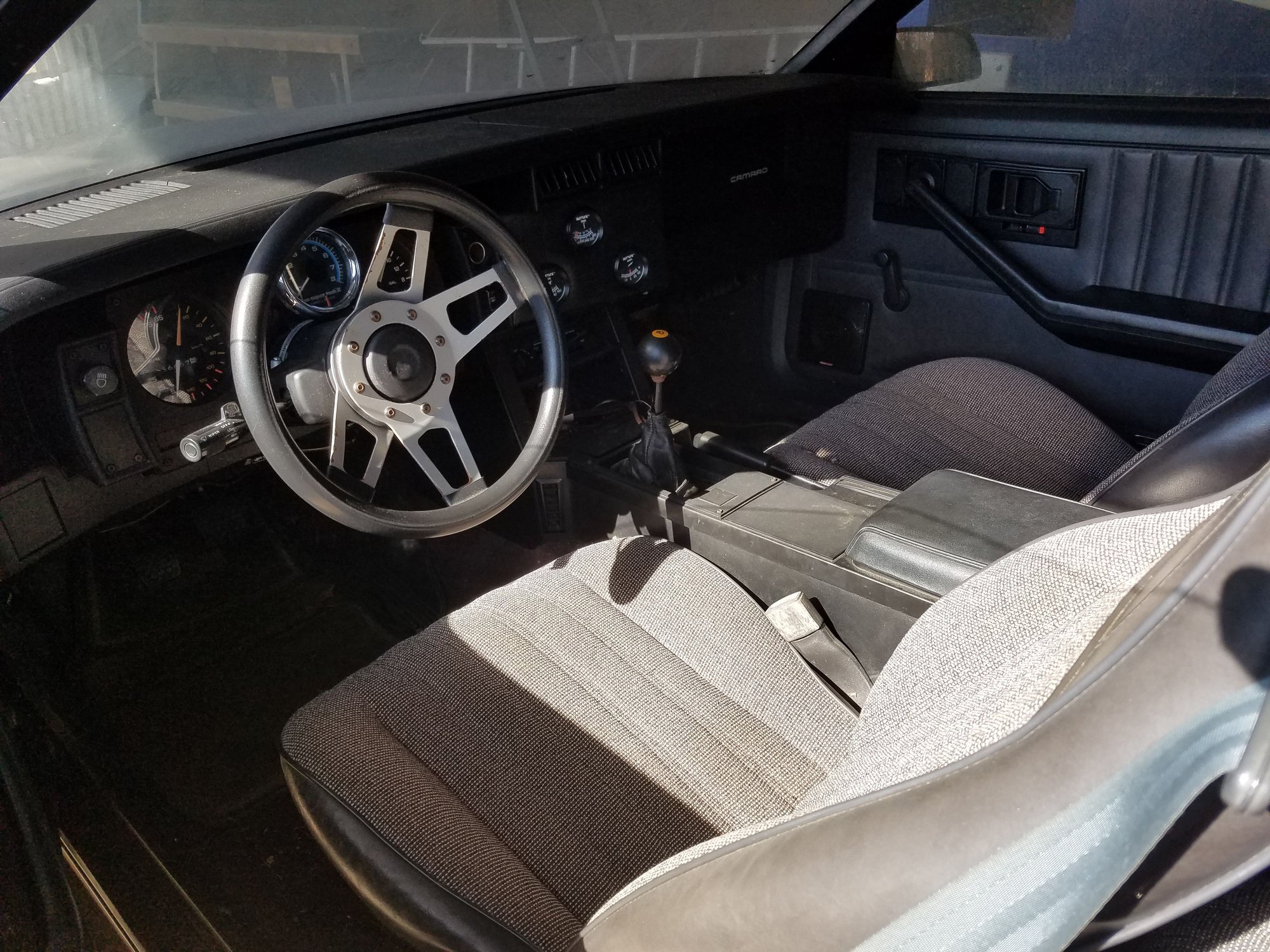

I'm looking for some opinions on engine swaps. I have an 83 camaro 2.8 5 speed that I just bought off of my uncle who bought the car brand new in 83. It has 66,667 original miles. Zero rust, never been driven in the winter and has been stored in a barn since the 90s. I'm starting at the rear and working my way forward while building this car. I know for sure I want to run a ford 9" with the ta. Planning on using a t56 out of a 4th gen. Here's where it gets tricky. I can't decide on what engine to put in the car. I have 5 different engines in my head that I want to swap in.
1. 454
2. 383 stroker
3. Dz302 made from 4 bolt 350
4. Ls of some kind, most likely lq9 or lq4
5. Turbo 3.8 (t-type/grand national)
Give me your opinions on what you would do if you had the car and those options. The goal for the car is just a fun daily driver that I could take to the strip on the weekends or to car shows.
