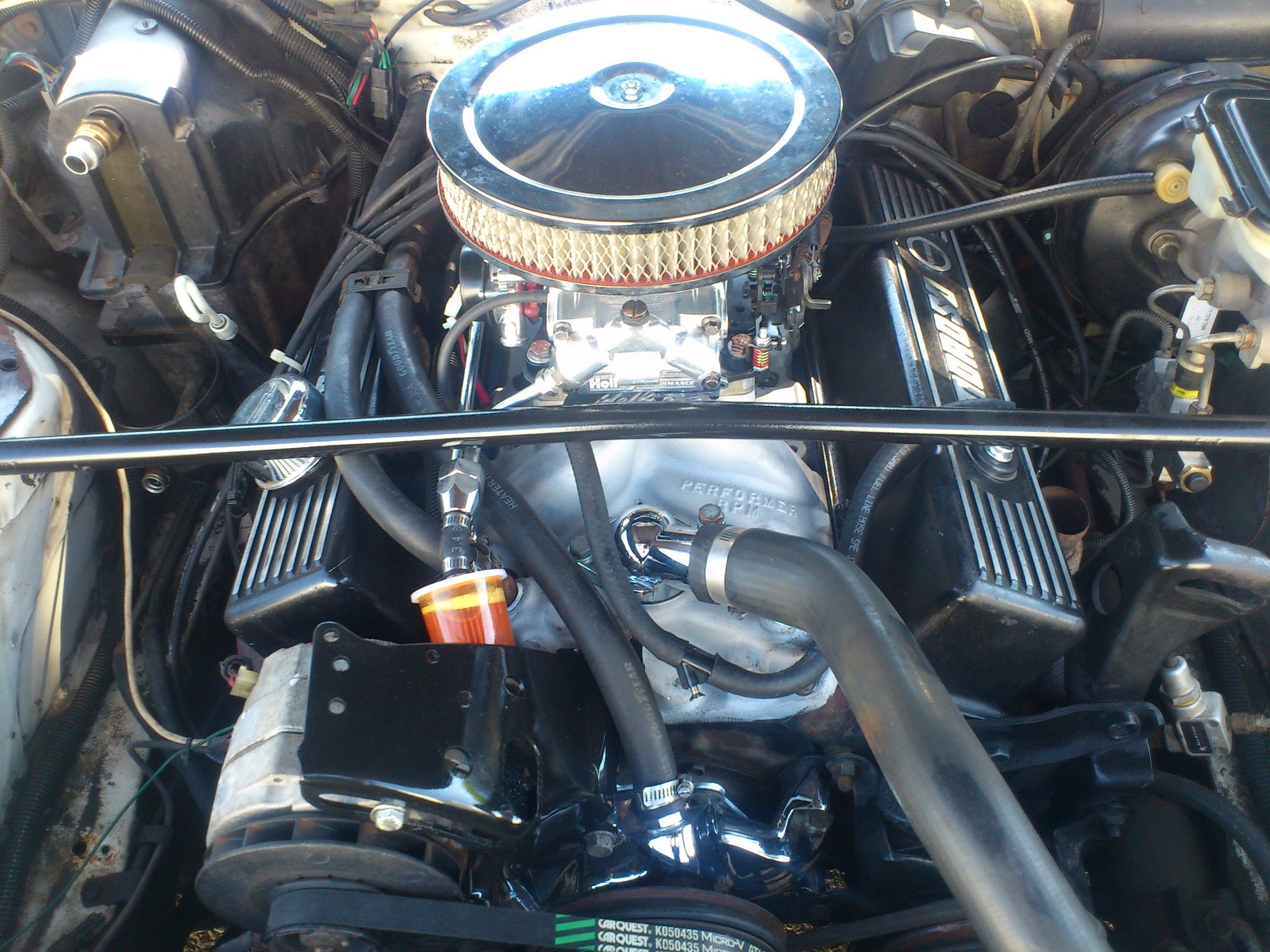

i currently have an lg4 305 in my car(a 1986 trans am)Ive done a few things as time and money allowed and i currently have a holley ultra 650 double pumper,an edlebrock rmp intake,and freshened up the hei(vacuum advance model).the car already had the original quadrajet removed as well as the computer controlled carb and the rest of the emissions equipment.i dealt with the hand i was given the best i could with what i have.
now i also have a gmpp 3896962 cam and lifters as well as hew flowtek shorty headers and y-pipe,should i install these or focus on installing another 305 that came with the car.it is a clean low mileage LB9 305 but does not have the tpi from a 1991 5 speed car.what are your thoughts and how would you proceed?
