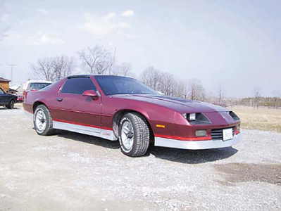

I have a 85 camaro z-28 the ;ittle lg4 but it isn't a computer controle quadrajet and i was planning on getting the conversion kit from Gm but i was wonder first if their would be any problems since the conversion kit is ment for a computer controled quadrajet
thanks for anyhelp
