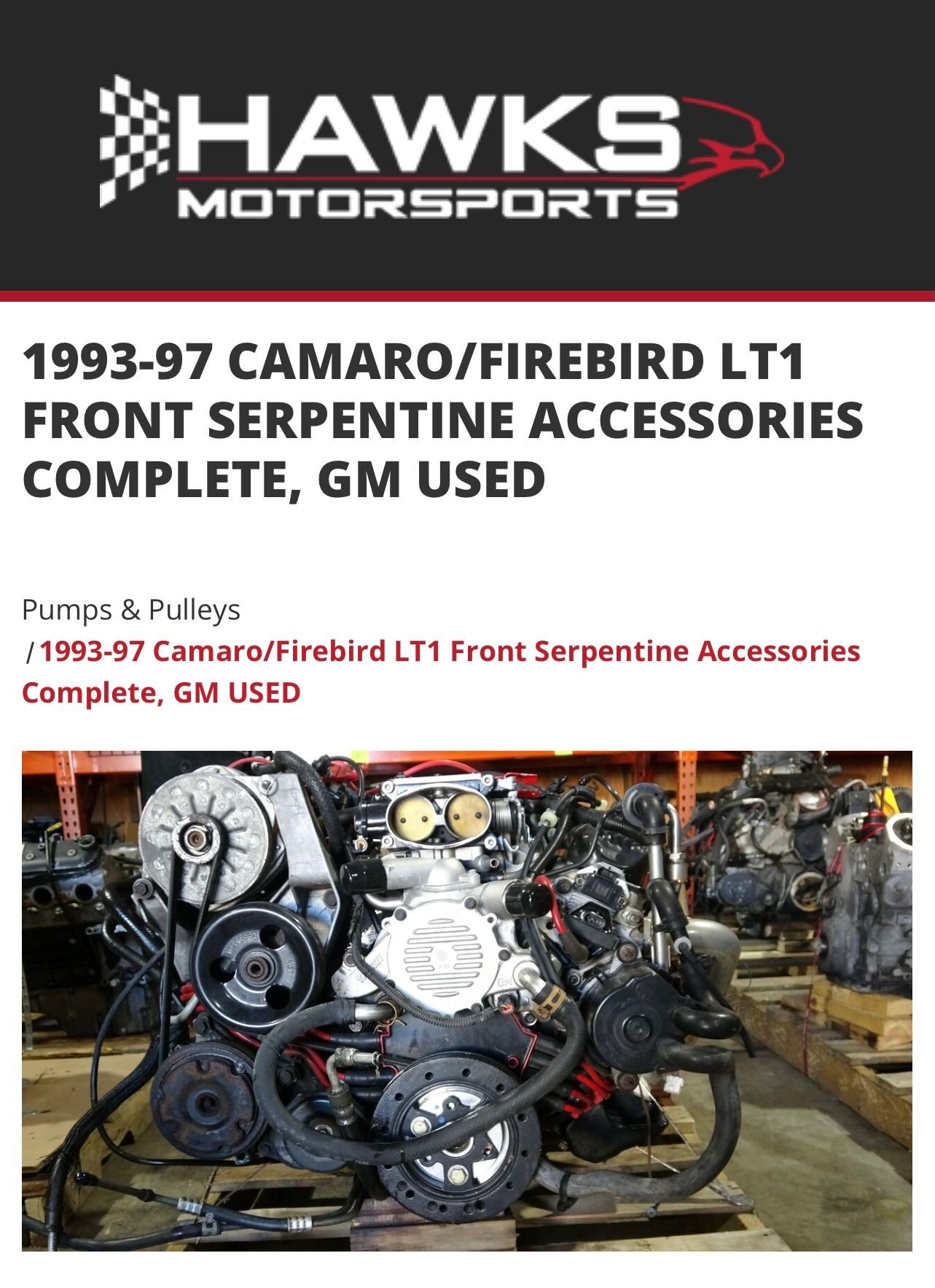

My next question is; can the accessory drive off of a 93-97 Camaro LT1 be used with my engine? There’s one for sale on hawks that I’m tempted to buy. The engine currently has all the truck accessories.
Old Mar 12, 2022 | 08:31 AM
Posts: 28,015
Likes: 2,492
Re: V6 to v8 swap help
No. Won't work. Needs to be 98-up.
