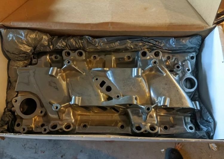

There actually was an Accel Gen II SBC TPI lower intake manifold base that allows you to run GM style TPI, Accel Street Ram, or Accel Super Ram on a Gen II SBC. Also made a shorter Super Ram plenum for the 4th Gen F body.
