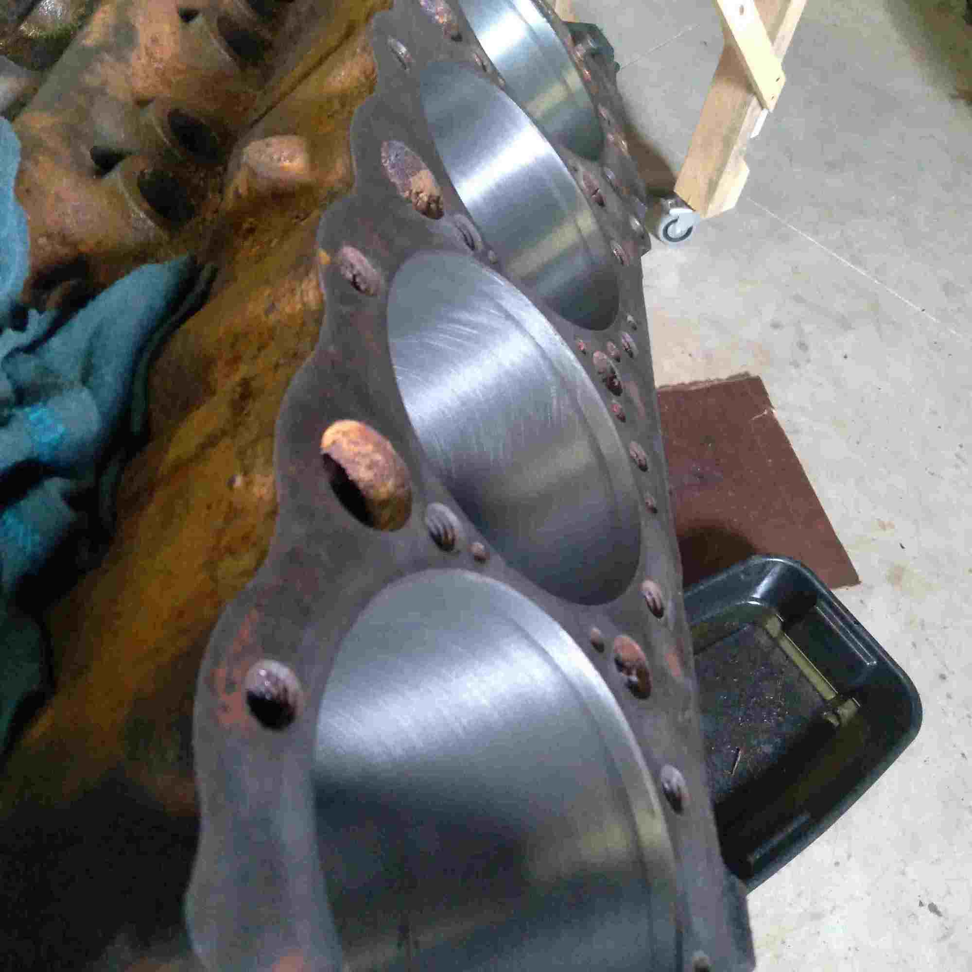

I have a sbc 400. Cylinders look good aside from ring ridge. You can not fell it with your fingernail. It will me a mild street build. Trans will shift at 5500 rpm. Will never see 6000rpm. High flow heads, mild cam. The cylinders mic 4.1255 - 4.126. Should I hone some more the get rid of ridge mark? or call it good?

Honestly could get the ball hone brush and hit it with the drill. I did that to my 7000 rpm 400sbc turbo motor and was fine.

Ball hone & dial bore gauge is on the way. I'll check the bore before I do more damage. Thanks. I have one piston that is 0.004 smaller than the rest so I might have to find a piston if I go with the OE pistons.

What grit Ball-Hone are you going to use?
...It makes a difference!
Goodson Tool is an excellent supplier for Engine reconditioning consumables and tools.

Also, I would not touch the Bores until you purchase your Pistons and know what the Piston to Cylinder-Wall Clearance needs to be.

The hone is 180 grit. What do you suggest?
I am planning on using the OE pistons but I have to find one because one piston is .003 smaller than the rest of them making the piston to cylinder clearance .007 on that one.

It sounds like you will have too much Piston to Wall Clearance...
But having an actual Spec. on those Pistons would be very helpful.
I would chat up an Automotive Machinist for a recommendation.
One Piston is 0.003" Smaller than the other Seven?
It's far from ideal to have different size Pistons... but a Bob-Weight alteration could make it work.
What is the weight difference between the Two different size Pistons?
What are you going to do in regard to Balancing the Rotating Assembly?

I don't have a scale that will weigh them. I will have it checked for cracks and I can ask them then.
I haven't thought that far out about balancing. It will be a low rpm engine, 5500. I didn't think balancing was critical for that rpm. But I'm not against balancing.

I think i used something much less gritty like a 240-320 something. I cant recall. Believe it was a flex hone brand ball hone brush
