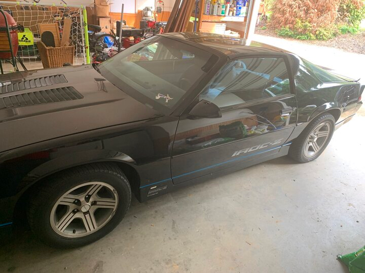

Is that a Mustang I see sitting back there?? Booooooo!
Just kidding. Sweet build specs. Let’s see some pics of the car it’s going into.

Yeah good point. And the Mustang for sure is not getting that engine.... just the exhaust

I figured I have waited a long time to build a hot rod and figured might as well do it right.... YOLO
I am worried that the stock hood is not going to work... I am wanting to keep it as stock-looking as possible.... you know for those Dodge Demons
