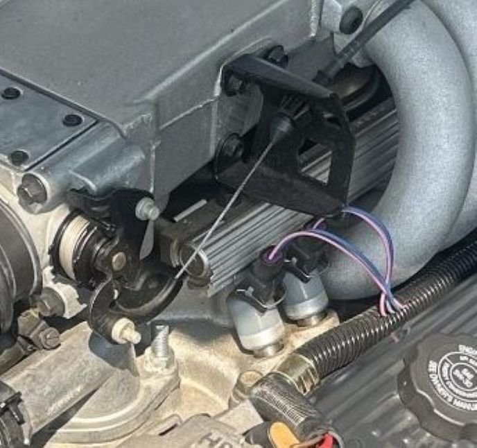

I want to thank everyone for all there help. my engine has a CSI and it fires during cranking process but not the other injectors until it starts, ii that what it is suppose to do? also how does a 1992 TPI fire without a CSI. The reason I'm asking is my 40 Chev has a 1990 TPI that don't have a CSI and after the 2 sec fuel pump it fires right up. trying to understand how the system works

I’m sure I’ve explained the csi operation on corvette form or here. So here goes again. The csi sprays fuel when craning only if timer switch is closed. Not ecm controlled. 89 maf uses cranking fuel and cold start enrichment logic same for tpi sd.

The 9th injector CSI system is 100% stand alone. The ECM doesn't even know it exists. If you took the entire CSI system off and threw it into the trash the ECM wouldn't know it was missing. There is no feedback or talking between them. Neither knows the other one is there.
On the 1989 and up TPI systems without CSI the ECM pulses the 8 injectors during cranking to add the extra cold start fuel needed to start the engine. The programming on the 1989 and up TPI systems is different from the 1988 and older systems.

Post some pictures of the engine. I want to be able to clearly see the fuel injectors.
RP Multec Fuel Injectors
There has been too much assuming and guessing troubleshooting your problems. I assume you have a 1988 L98 engine and not a 1989+ L98 engine. I assume you sent out the stock injectors out to be serviced and that they are not Rochester Products Multec fuel injectors.
I'm done assuming and guessing. A picture tells a thousand words.
RP Multec fuel injectors are the Devil. They are retroactively defective by design. Little ugly hand grenades with the pins pulled so far out you just look at them the wrong way and BOOM. Even if they test good they are bad. All of them are bad.
They will make you chase your tail around in circles and pull your hair out by the roots.
The flowchart for troubleshooting them is #1 Open hood and look at the fuel injectors, #2 Are they RP Multecs, If YES then throw all 8 of them into the trash can and replace with brand new Delphi fuel injectors, If NO then keep troubleshooting the problem.
These little MFers love to run good when cold but when they get warm or hot that's when the nightmare party starts.

Never mentioned if this was a cold or hot ohm reading.
Originally Posted by snackstick
I had the factory Injectors that came with the engine rebuilt, not sure what # they are. I ran a resistance check a while back and they were 16.1 to 16.3. I will check them again. I also have purchased a adjustable fuel regulator and will get it installed within a few days. Thank you

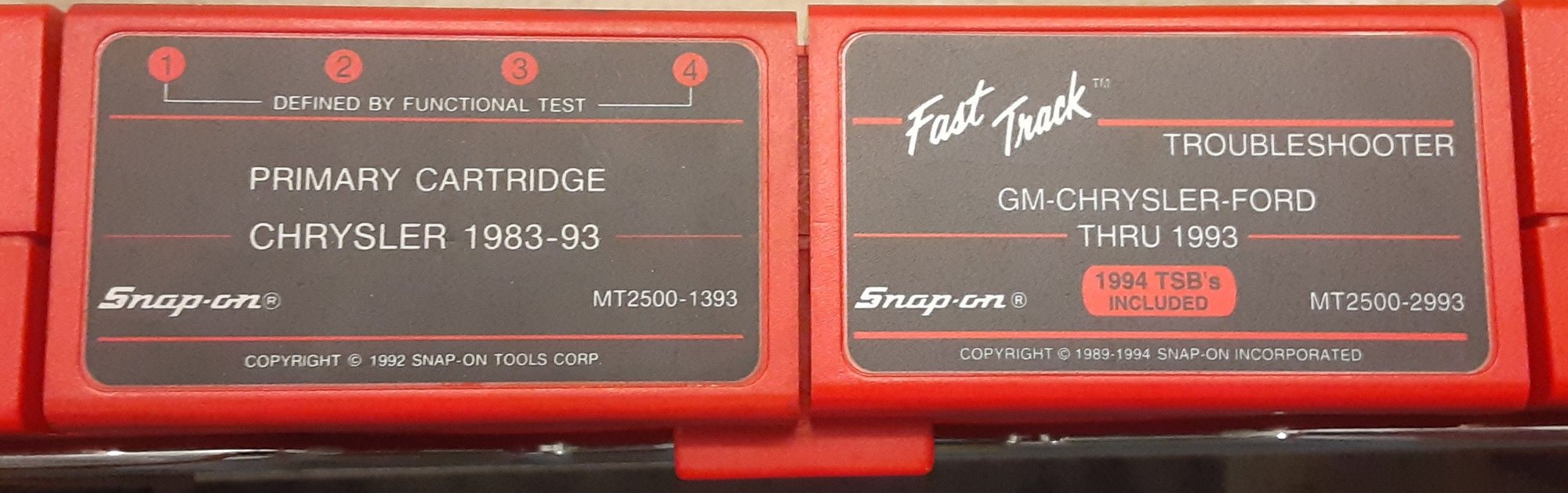

Old Apr 30, 2026 | 06:18 PM
  #85
Airwolfe's Avatar
Joined: Oct 2020
Posts: 1,411
Likes: 675
Car: 1992 Pontiac Firebird
Engine: 5.0L L03 TBI
Re: 88 L98 not starting when warm
Here TP,
OK. Those aren't RP Multecs. So the problems isn't RP Multec fuel injectors.
Old Apr 30, 2026 | 06:24 PM
  #86
Airwolfe's Avatar
Joined: Oct 2020
Posts: 1,411
Likes: 675

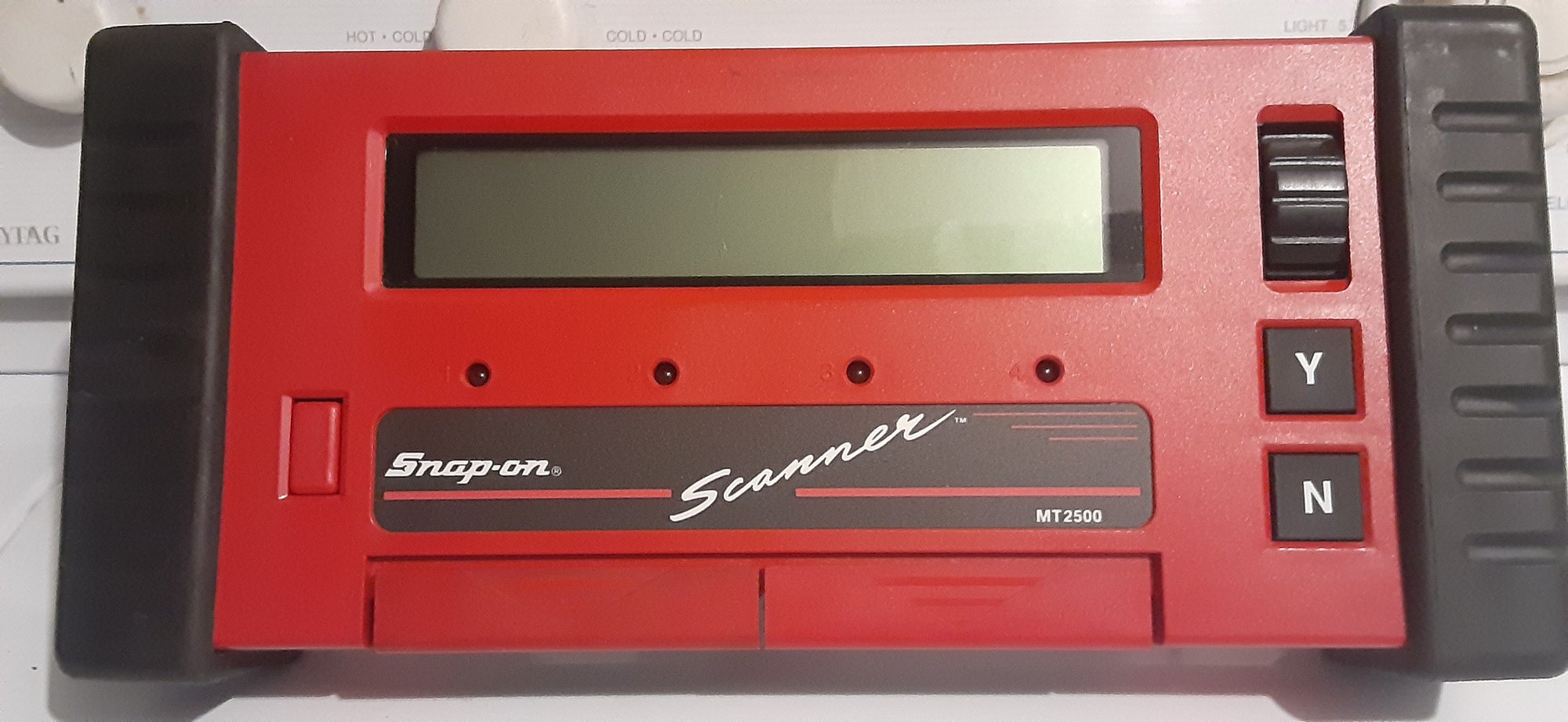

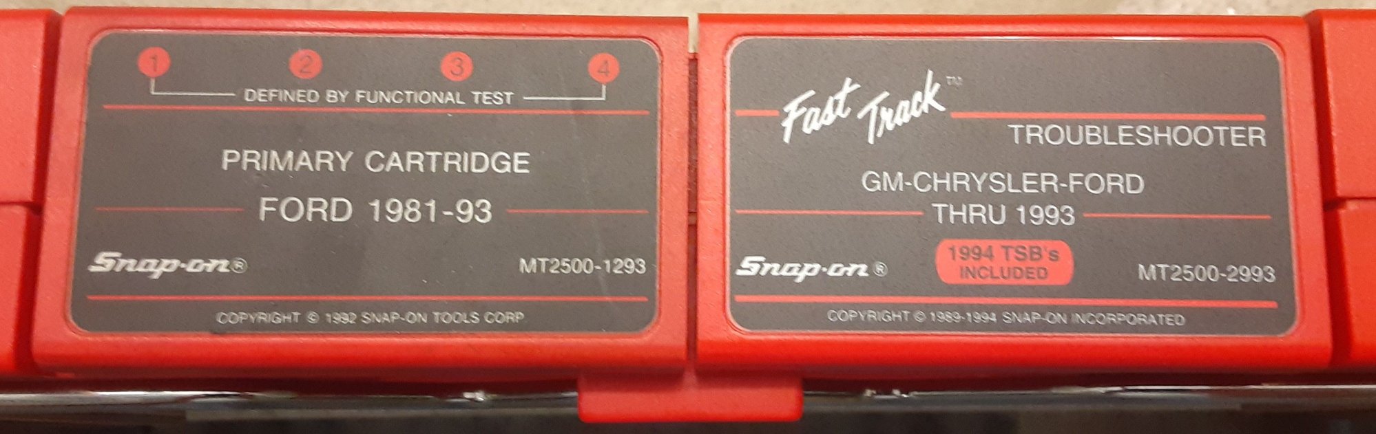

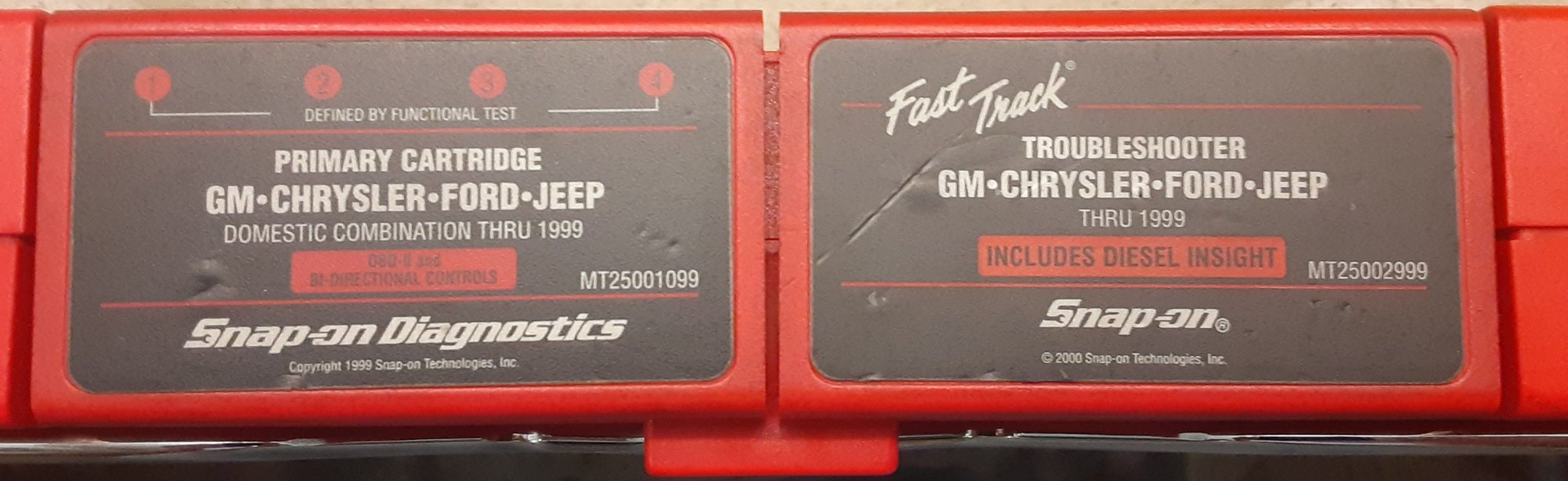

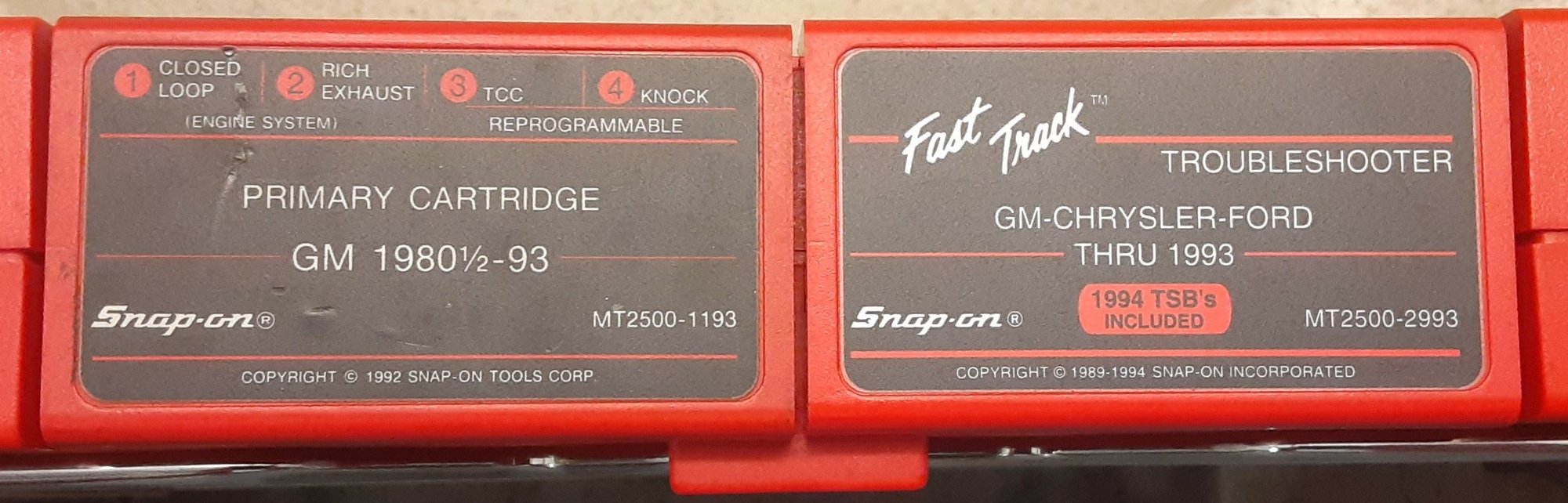

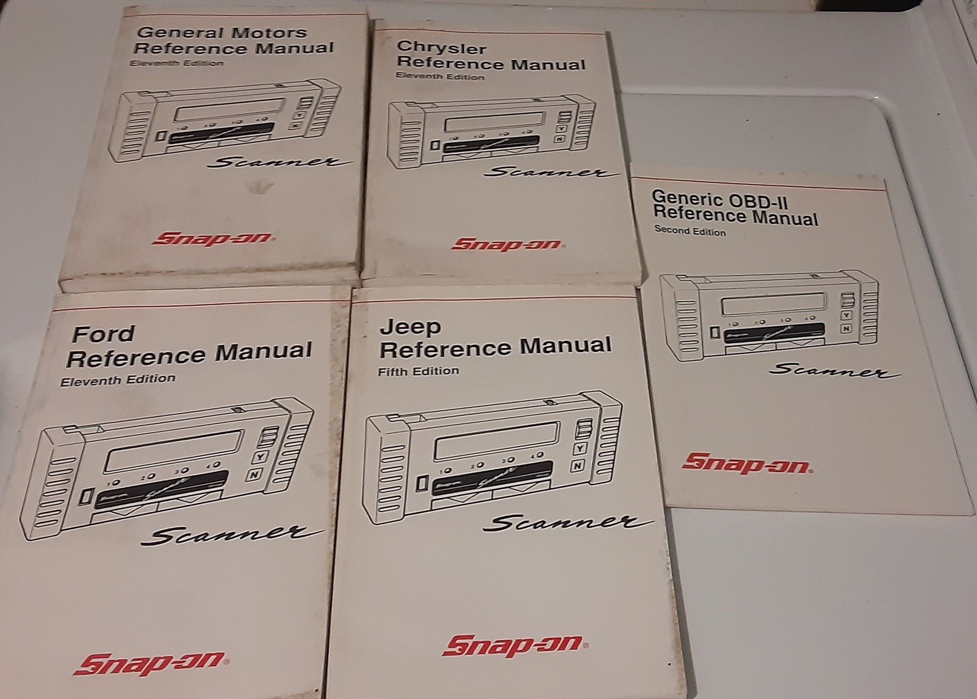

can anyone recommend a OBD1 live data scanner that won't break the bank.
What do you consider not breaking the bank?
I have plenty of Snap-on MT2500 Scanners in perfect condition and Primary and Fast Track Troubleshooter cartridges for them too.
Snap-on MT2500 Scanner hardware version 1.8 without backlit screen.
1980.5 to 1993 GM Primary Cartridge with thru 1993 US Domestic Fast Track Troubleshooter Cartridge.
Above is the minimum you will need for a Snap-on MT2500 Scanner with the Primary & Fast Track Troubleshooter cartridges to diagnose your car or truck or whatever it is you have with a 1988 L98 engine. Also it would come with the Snap-on data cable and the Snap-on GM-1 OBD-I adapter you will need and a Snap-on 12 VDC battery power cable you need to plug into the Snap-on GM-1 OBD-I adapter. GM's 12 pin ALCL/ALDL (OBD-I) diagnostic port doesn't supply positive 12 VDC power.
It won't come with a Snap-on 12 VDC cigarette lighter power adapter if you just get the GM Primary cartridge because the Snap-on one loves to self eject from every single GM cigarette lighter/power outlet I've ever plugged one into. I wouldn't subject anyone to that bullshit. It sounds just like a M1 Garand ejecting the clip after firing the 8th round of ammo. Also you will run into vehicles that don't have a working cigarette lighter/power socket more often than you would think.
What all cars, SUVs, and trucks do you have? Year, make, and model. Plus stuff you have engine swapped and with what year, make, and model engine?
1983 to 1993 Chrysler Primary Cartridge with thru 1993 US Domestic Fast Track Troubleshooter Cartridge.
1981 to 1993 Ford Primary Cartridge with thru 1993 US Domestic Fast Track Troubleshooter Cartridge.
Thru 1999 4 in 1 US Domestic Primary Cartridge with thru 1999 4 in 1 US Domestic Fast Track Troubleshooter Cartridge. The JEEP coverage starts at 1984.
Example of US Domestic ODB-I & ODB-II Reference Manuals & Generic OBD-II Reference Manuals.

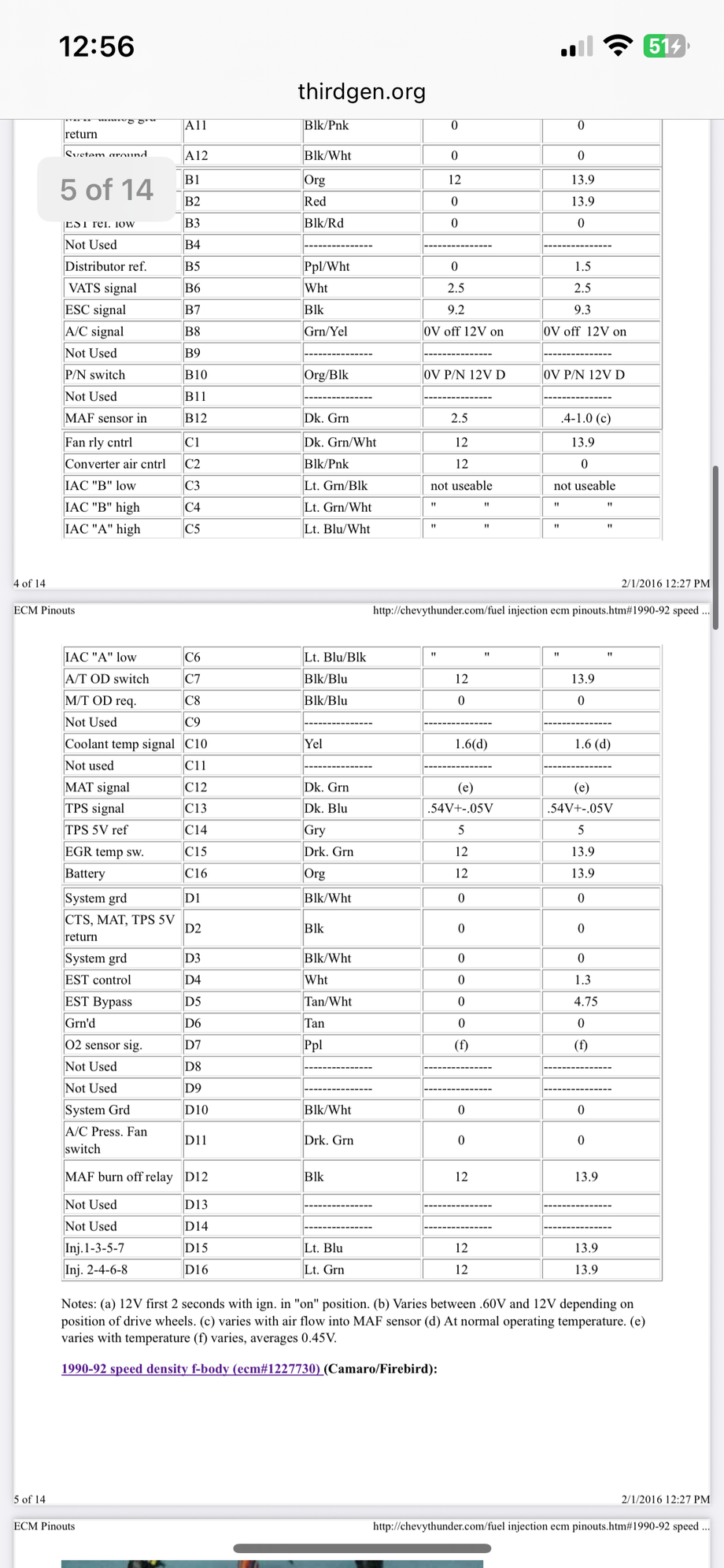

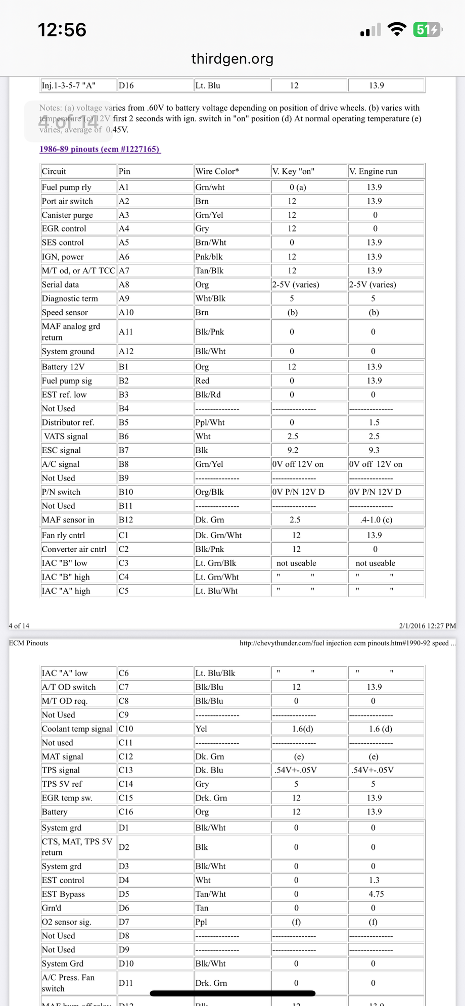

The schematic is located in the pdf on your thread. The pinout I posted on cf, 2 constant hots B1.C16 and one switched power a6. High tps reading, shorted injector coils, ecm not seeing drp because it’s bad or reference wire or icm has an issue. All possible causes no injector pulse engine warm.
